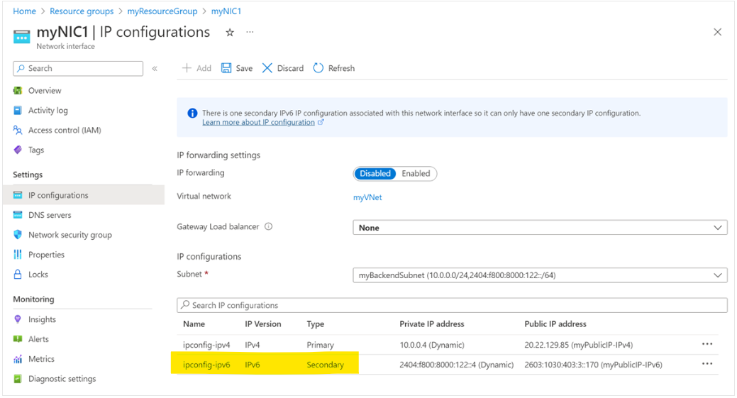

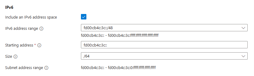

    The subnets for IPv6 must be exactly /64 in size. This ensures future compatibility should you decide to enable routing of the subnet to an on-premises network since some routers can only accept /64 IPv6 routes.
    So, your IPv6 range should be something like fd00:db8:deca:deed::/64 or 2001:db8:3c4d:15::/64 and not /112 or /120.
    All the information for IPv6 usage and limitations can be found in the below docs:
    https://learn.microsoft.com/en-us/azure/virtual-network/ip-services/ipv6-overview
    https://learn.microsoft.com/en-us/azure/load-balancer/load-balancer-ipv6-overview
