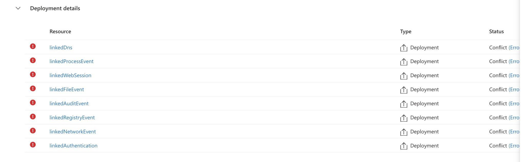

How to update ASIM on Microsoft Sentinel? because i try to reinstall from this template its failed and conflict : https://github.com/Azure/Azure-Sentinel/tree/master/ASIM

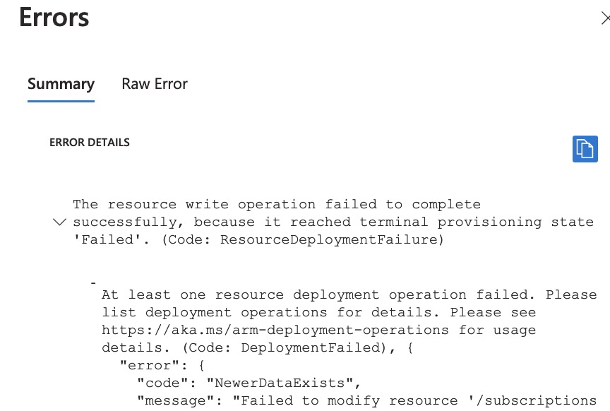

    When it comes to your ASIM Deployment issue, I was able to reproduce it within my Azure tenant and it looks like this is a known issue with one recommend workaround, which I'll share below.
    MVP Recommended Solution:
    Hi, This behavior is as expected due to the following reason.
    When deploying the ASIM parsers using the ARM templates a POST request is done at the background. Because the ASIM parsers already exists, this will result in an error as described above. There are 2 workarounds to remediate this issue:
    • Remove the existing ASIM parsers for the workspace using the Microsoft PowerShell script
    • Deploy the updated parsers using the API using the UPDATE method.
    It is more an issue related to Log Analytics than Microsoft Sentinel or ASIM as they are dependent on Log Analytics.

    This issue is still being looked into. This seems more of Log Analytics issue than Sentinel, we are working with concerned teams to get this fixed.
    When looking more into this, I did notice that I already deployed these ASIM parsers previously, which could also be contributing to the issue. I'd also recommend, ensuring your Microsoft Sentinel Log Analytics workspace doesn't already have these tables.
