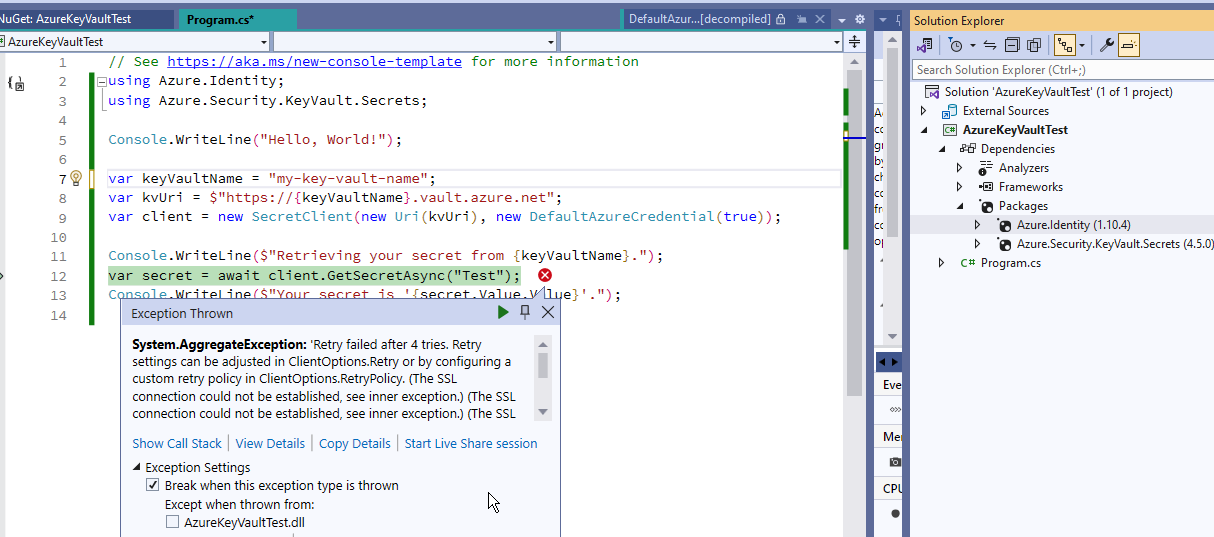

It looks like an unexpected issue in my local develop box when accessing KeyVault.
Is there anything will cause this problem ? thank you.
My device:
  • Windows 10 Enterprise 22H2
  • Installed .NET SDK Version
    • 3.1.416
      • 6.0.403
        • 8.0.100
System.AggregateException
  HResult=0x80131500
  Message=Retry failed after 4 tries. Retry settings can be adjusted in ClientOptions.Retry or by configuring a custom retry policy in ClientOptions.RetryPolicy. (The SSL connection could not be established, see inner exception.) (The SSL connection could not be established, see inner exception.) (The SSL connection could not be established, see inner exception.) (The SSL connection could not be established, see inner exception.)
  Source=Azure.Core
  StackTrace:
   at Azure.Core.Pipeline.RetryPolicy.<ProcessAsync>d__5.MoveNext()
   at Azure.Core.Pipeline.HttpPipeline.<SendRequestAsync>d__18.MoveNext()
   at Azure.Security.KeyVault.KeyVaultPipeline.<SendRequestAsync>d__29.MoveNext()
   at Azure.Security.KeyVault.KeyVaultPipeline.<SendRequestAsync>d__21`1.MoveNext()
   at Azure.Security.KeyVault.Secrets.SecretClient.<GetSecretAsync>d__8.MoveNext()
   at Program.<<Main>$>d__0.MoveNext() in C:\Users\jasonliu\source\repos\AzureKeyVaultTest\Program.cs:line 12
   at Program.<Main>(String[] args)

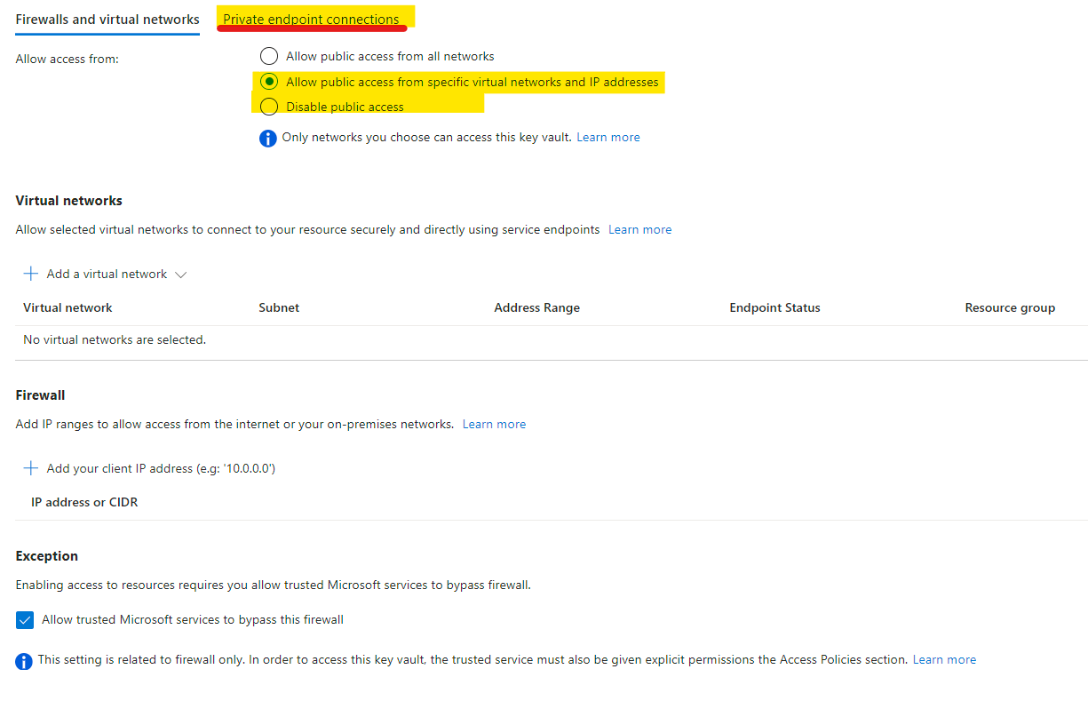

    This may a network configuration issue on Azure KeyVault:
    You must have configured Disable public network or allow public access from specific virtual networks and IP addresses.
    And for any source the IP must be whitelisted.

    The issue is resolved by adding private endpoint in our Azure KeyVault service.
    Again, thanks for your help.
