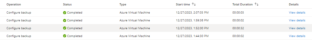

Configuration backup status is completed but when checking its details showing no result.

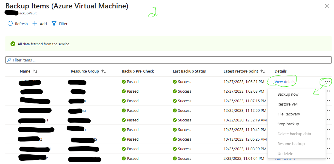

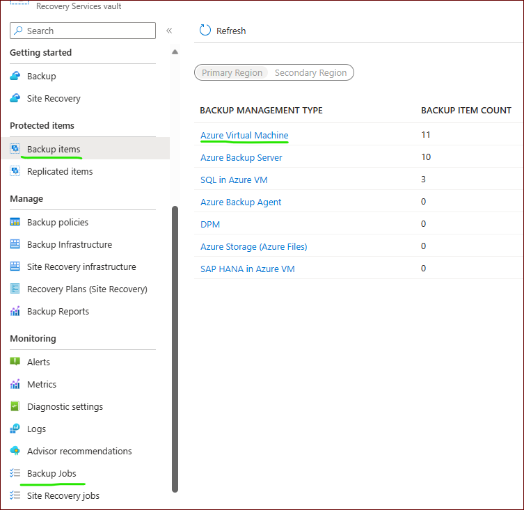

    Hello, follow the steps below to confirm if your backup is running successfully or not.
    1. Go to the Recovery Services vault where you are backing up your system and click on it.
    2. Click on the Backup items blade -> click Azure Virtual Machines -> for the VM in questions click on View details ->you will see the list of all the backups for the VM to include the creation time. If the VM was backed up successfully you can click the ellipsis (... dots) and click Restore VM if you would like to test the restore.
    3. You can also go back to the previous windows (Backup Items blade) to the list of VMs being backup then click on the ellipsis for the VM and click Backup now to start a backup.
    4. Go back to the Recovery Service vault and click on Backup jobs. This is the blade where you can see restore and backup jobs in progress. The attached screen captures show where the options mentioned above are located.
    If your backups are not working, you might have to Stop backup -> disable the backup and re-enabled itRecovery Service Vault
