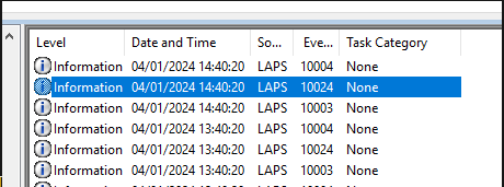

We had a working Microsoft LAPS. However, we decided we wanted Windows LAPS so we:
](https://i.stack.imgur.com/iQYGz.png)
However, the Windows LAPS is doing nothing. The event viewer is showing successions of events 10003, 10024, and 10004. 10024 LAPS policy is configured as disabled.
[LAPS 10024
](https://i.stack.imgur.com/wzz0z.png)
Moreover, the ADUC computer properties are showing the LAPS tab but blank account name and password. [LAPS Tab
](https://i.stack.imgur.com/RRq39.png)
We rerun the configuration but we cannot seem to find what is amiss. We checked the Windows hotfix and we have the "2023-11 Cumulative Update for Windows Server 2019 for x64-based Systems (KB5032196)".
We have Windows Server 2019 but we have "Windows 2012 R2" domain functional level.

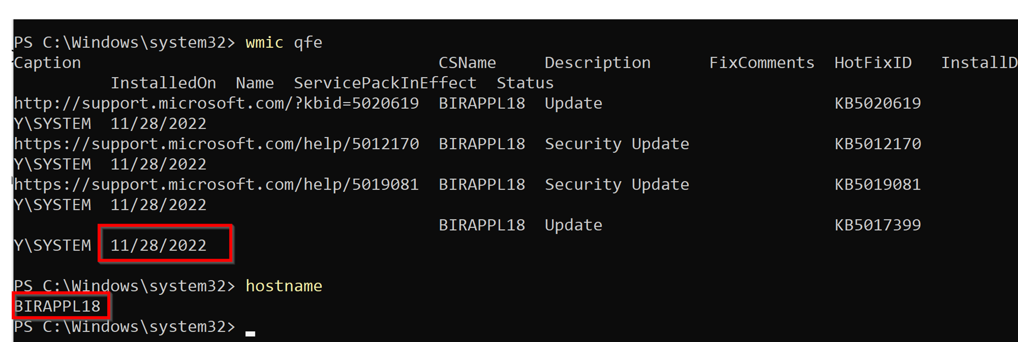

    Have also found the problem cause: The test system was on an old patch level, from November 2022. And the new LAPS was introduced in mid 2023.
    birappl18
    After trying with another testsystem and after updating birappl18, LAPS worked as expected.

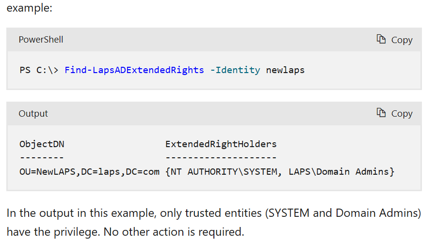

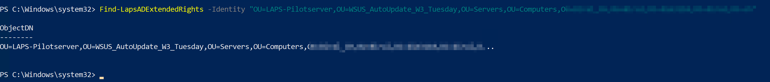

    What I still can't understand and what leads me to the wrong way is that the "Find-LapsADExtendedRights" still shows no output, despite the domain admins have the right to decrypt passwords (LAPS default configuration).

    Was able to solve the problem: The test system was on an old patch level, November 2022. The new LAPS was introduced mid 2023.
    birappl18
    What I still can't understand and what leads me to the wrong troubleshooting way is that Find-LapsADExtendedRights still doesn't show the "Domain Admins" as a result.
