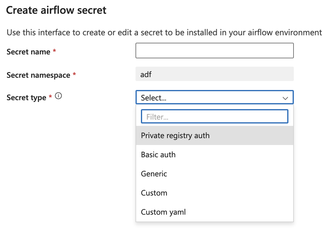

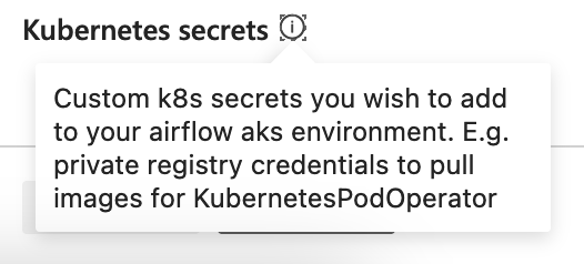

I've been experimenting with the Managed Airflow feature in Azure Data Factory (ADF), and I've noticed in the user interface for creating/editing an Airflow integration runtime that it mentions Kubernetes secrets and Azure Kubernetes Service (AKS), as seen in the screenshot below: User's image
So it seems like the Managed Airflow service is powered by AKS under the hood. Is there a way for us to access this AKS cluster using an Airflow KubernetesPodOperator (is the kube config file located somewhere in the file system that we can access?), or is this not supported? Would we have to set up a separate AKS cluster ourselves in order to use the KubernetesPodOperator?

    For Airflow running in a Kubernetes environment, especially when managed by a service like Azure Data Factory, it's best to follow the service's guidelines for secret management. If Airflow is managing the deployment of the KubernetesPodOperator, it will typically expect the secrets to be in the same namespace as where the operator is running. If you need to use secrets in Airflow tasks across different namespaces, you would typically replicate those secrets to the namespaces where the tasks will run.
    The dropdown you're seeing for the secret type (Private registry auth, Basic auth, Generic, etc.) is specifying the format or usage of the secret.
    For instance, "Private registry auth" could be used to store credentials for accessing private Docker registries.

    • Kubernetes secrets: You can create a custom Kubernetes secret for your Airflow environment. An example is Private registry credentials to pull images for KubernetesPodOperator.

    As you can see, I've specified the "adf" namespace and just used the simple "hello-world" image, but altogether it was very straightforward with minimal configuration. Is this the intended way to use the KubernetesPodOperator in ADF Managed Airflow? I also noticed when adding Kuberentes secrets to my Airflow Integrated Runtime, that the "Secret namespace" is "adf", so that's why I'm using that namespace, although "default" also works. But if I want to have access to the secrets that I specify in my Airflow tasks, then obviously I need to use the "adf" namespace. User's image
    Please let me know if this lines up with your understanding of using the KubernetesPodOperator in ADF Managed Airflow. Thanks.
