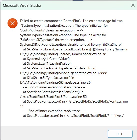

    I have uninstalled VS2022, reinstalled VS2022 and have same plus new problem. Repaired VS2022 and have the same plus new problems. Started a new project to test VS2022 Microsoft Visual Studio Community 2022 (64-bit) - Current Version 17.8.5 .NET Framework 4.7.2 project Added a timer1 to the Form1.cs(Design) and a textbox. In the timer it increments a Count and displays it in the textbox which builds and runs. In NuGet-Solution, Installed ScottPlot.WinForms. When I dragged the 'FormsPlot' from ScottPlot.WinForms in toolbox, I get the following error, Error Image 1-25-24
    It looks like it is trying get something on my "" drive that does not exist. Any suggestions how to fix?
