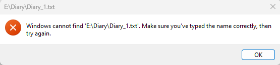

Sakite Sakite • 0 Reputation points
2024-01-19T14:54:54.3866667+00:00 This is the error and it happens for all .txt files.
2024-01-19T14:56:20.1466667+00:00 when I try type E:\Diary it says Acces denied, idk why
MotoX80 • 36,416 Reputation points
2024-01-19T16:02:28.54+00:00 Use the Windows explorer and check the folder security permissions.

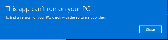

2024-01-20T15:36:47.84+00:00 This is the error I get when I try to open the .bat file:
2024-01-20T16:00:05.53+00:00 Something is really wrong
I would agree.
Open a command prompt with "Run as administrator", CD to the folder where you put the file and run it from there.
You might first want to run a Windows Defender full scan of your PC. Also run MS's MRT tool. https://www.bing.com/search?q=windows+mrt
