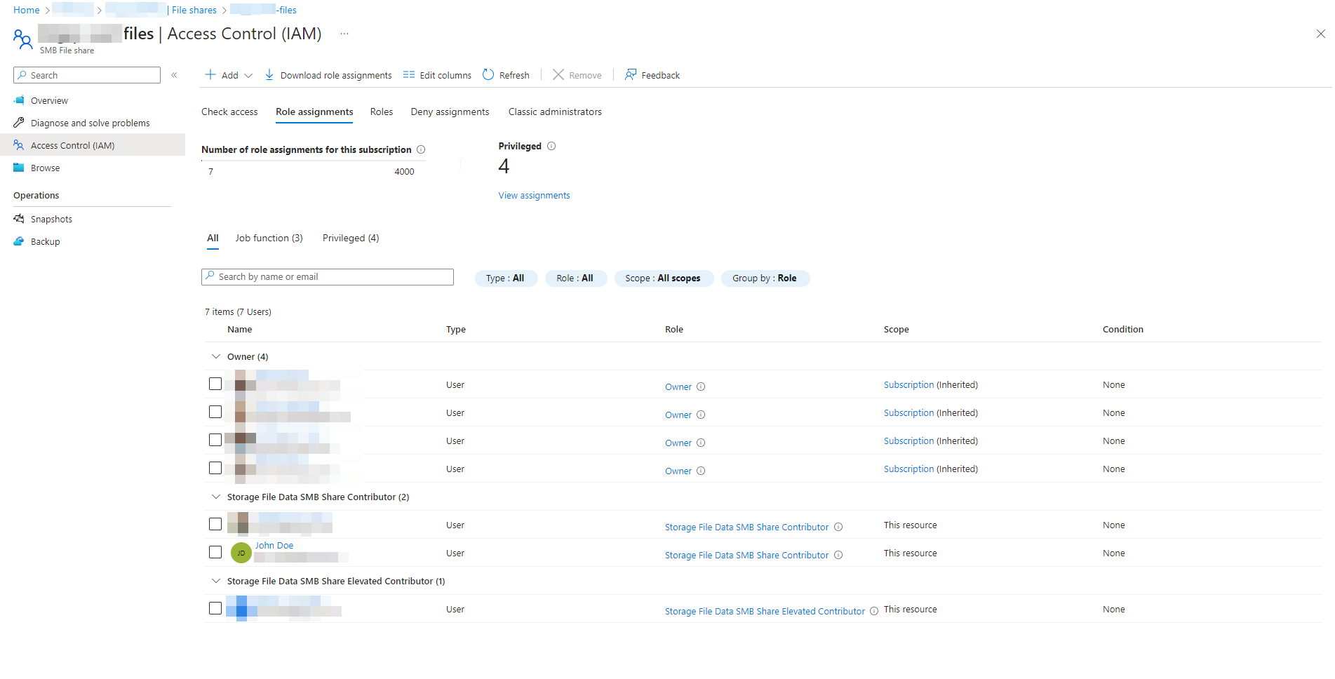

I have gone through the AzFilesHybrid setup as indicated for using the Active Directory Domain Services configuration and that all checks out fine as far as I can tell. I have the default share-level permissions set to Storage File Data SMB Share Reader since for at least this test environment I don't mind having the minimum access being read only. And then I have setup a non-administrative test user in the Access Control to have Storage File Data SMB Share Contributor role for the file share. I use the provided script for Active Directory or Microsoft Entra to map the drive to the letter Z and it successfully maps without issue. However, when I try to create a new file or folder I am given the message that I need permission to perform this action. If I change the default permissions to Share Contributor and disconnect the drive and re-run the connection script, then I can write to my heart's content. If I disable the share-level permissions entirely then I am unable to map the drive at all which tells me that the IAM Access Controls are doing nothing but I am unsure as to why. But at the same time if I try to map the drive logged into the computer as a local user it fails regardless of any of the above scenarios meaning that some sort of authentication must be taking place. I'm not sure if I missed a step somewhere or if there isn't something configured correctly somewhere else within our account. So how do I make the RBAC roles actually work on a synced AD?

  1. Brian Gawith 20 Reputation points
    2024-02-15T14:03:29.2066667+00:00
    I was able to get the RBAC role assignments to work when using an AD Synchronized group with the wanted users in that group and then the roles assigned to the group.
