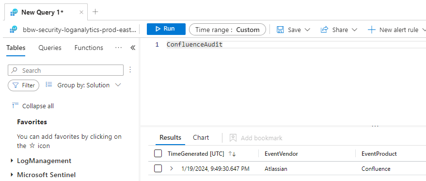

Hi- I deployed the Atlassian Confluence Audit Connector for Microsoft Sentinel via Azure Functions following this article (https://learn.microsoft.com/en-us/azure/sentinel/data-connectors/atlassian-confluence-audit-using-azure-functions). However, in Sentinel I only see one entry coming in and it isn't log data (see attached picture). Why is the function app connector behaving like this? I believe there is an issue with the Function App because I use the same credentials to test the REST API in Postman and I get log data back.User's image

    @Wong, Vincent Thanks for reaching out. Can you please validate if you see any runtime error/exception on your function app? You can also review the Diagnose and solve problems on your function app to confirm if there is any issue with your function app. I will also suggest to review these steps again as it may be a configuration issue.
