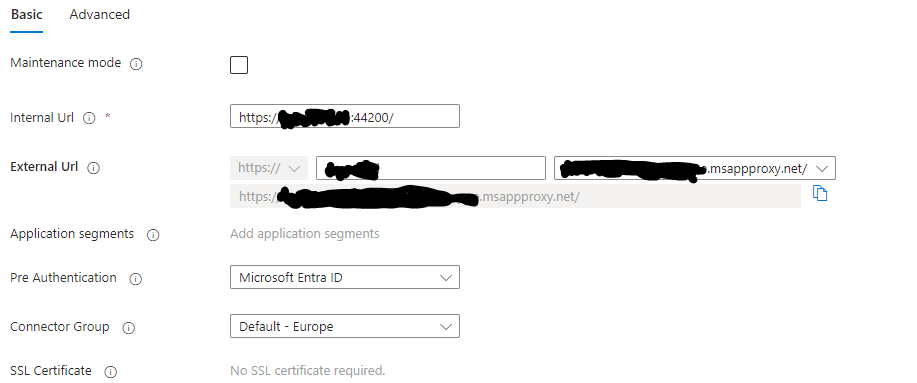

Hello, we use the Application Proxy in Azure. I have created an application and released it. The application runs on a server where multiple web applications are running, so the page must be accessed via a specific port. (Example: https://webserver:50001). I have specified this as the internal URL. The page can also be successfully accessed. The problem now is that when I want to log in to the page, it is done via a different port (Example: https://webserver: 50002). Here the login times out because the server is not accessible via the port. My guess is that this is because I only specified https://webserver:50001 as the internal URL. How can I solve this problem? How can I specify multiple ports?

    If you have tried the Translate Urls in application body without luck , then yu have to take care of this redirection .
    https://learn.microsoft.com/en-us/entra/identity/app-proxy/application-proxy-application-gateway-waf
    https://learn.microsoft.com/en-us/azure/application-gateway/how-application-gateway-works
    I suggest you have a look on Application Gateway integration , but even this will be an issue , since the Login is via a Different Port , maybe there is a solution , you have to create another URL mapping while
    maintinaing the intial URL
    For example
    https://application:5000 --> used to login
    https://application:5000/signup --> used to signup Application Gateway can solve this issue and offers advanced configuration elements as well
    I hope this helps!
