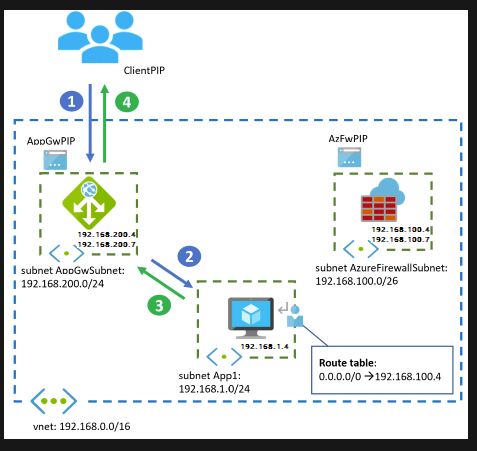

    • If Application Gateway is located in the same VNET as backend HTTP server then the system routes I mentioned above are already created, so when a request arrives at Application gateway it is forwarded to the Backend HTTP server. The response packet will use the system route and forwards the traffic to application Gateway again (This traffic flow is expressed in the image below). Now even though you have a default route for the VM's subnet 0.0.0.0/0 to NVA this route will not be selected because the system route is more specific. This section here on how azure selects a route can be helpful in understanding this scenario.
    If this is the desired traffic flow then only the default route mentioned in your question is required and not additional UDRs should be added.
