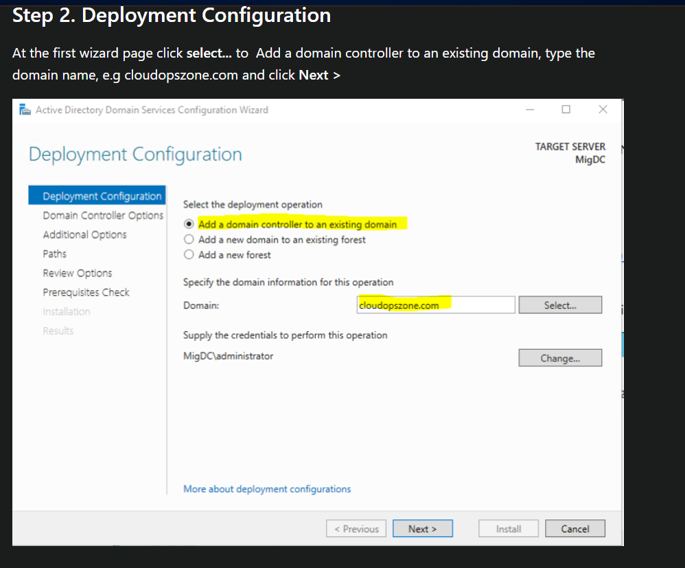

    Additional resources :
    Let me know if this help you.
