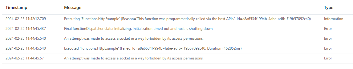

Go Azure Function is throwing 504 gateway error when i hit from POSTMAN or Azure Code + Test
raviteja aketi 45 Reputation points
2024-02-23T18:36:23.99+00:00
Full Exception : Exception while executing function /Functions.FunctionTwo ---> System.Net.Http.HttpRequestException  /Connection refused (127.0.0.1:41435) ---> System.Net.Sockets.SocketException  /Connection refused    System.Net.Sockets.Socket.AwaitableSocketAsyncEventArgs.ThrowException(SocketError error,CancellationToken cancellationToken)    System.Net.Sockets.Socket.AwaitableSocketAsyncEventArgs.System.Threading.Tasks.Sources.IValueTaskSource.GetResult(Int16 token)    async System.Net.Sockets.Socket.

    Issue:
    You were getting below error for your Go language azure function where you were trying to hit the endpoint from postman or testing it from azure portal function app code+test blade.
    Solution:
    You found the previous discussion here and found the root cause of the issue. You were building the binary and uploading the zip file manually by using az commands from my your mac machibe but your chosen server was Linux. You found that you should build it for Linux environment. For example GOOS=linux GOARCH=amd64 go build handler.go
    Thank you again for your time and patience throughout this issue.

  1. raviteja aketi 45 Reputation points
    2024-02-25T16:54:18.97+00:00
    Check here once.
    https://learn.microsoft.com/en-us/answers/questions/1180861/httpclient-error-an-attempt-was-made-to-access-a-s
    I found the reason for the raised issue. I was building the binary and uploading the zip file manually by using az commands from my mac. But my choosen server is linux. I should build it for linux environment. For example GOOS=linux GOARCH=amd64 go build handler.go
