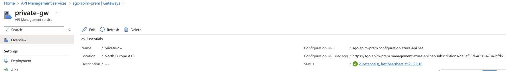

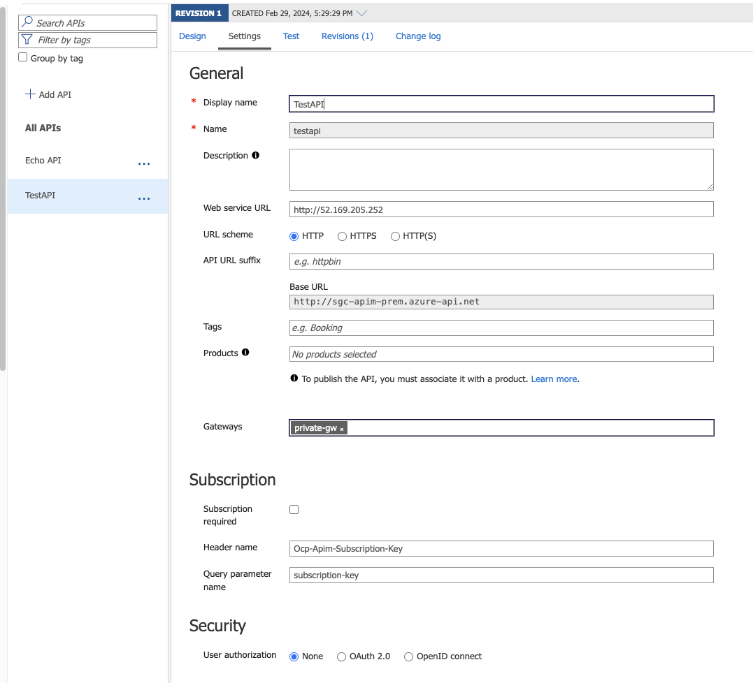

I have deployed APIM self hosted GW to AKS and it is up and running User's image

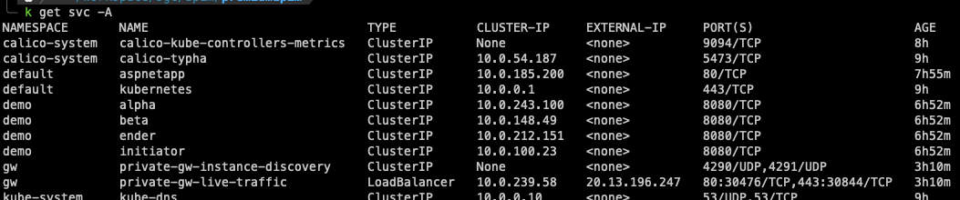

this gateway got exposed using ingress User's image

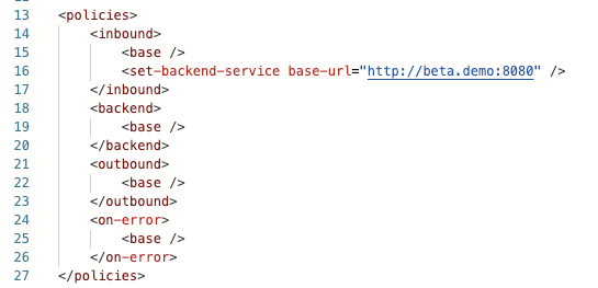

I create my API with self hosted GW and I would expect to call my it and get routed to beta svc in demo namespace

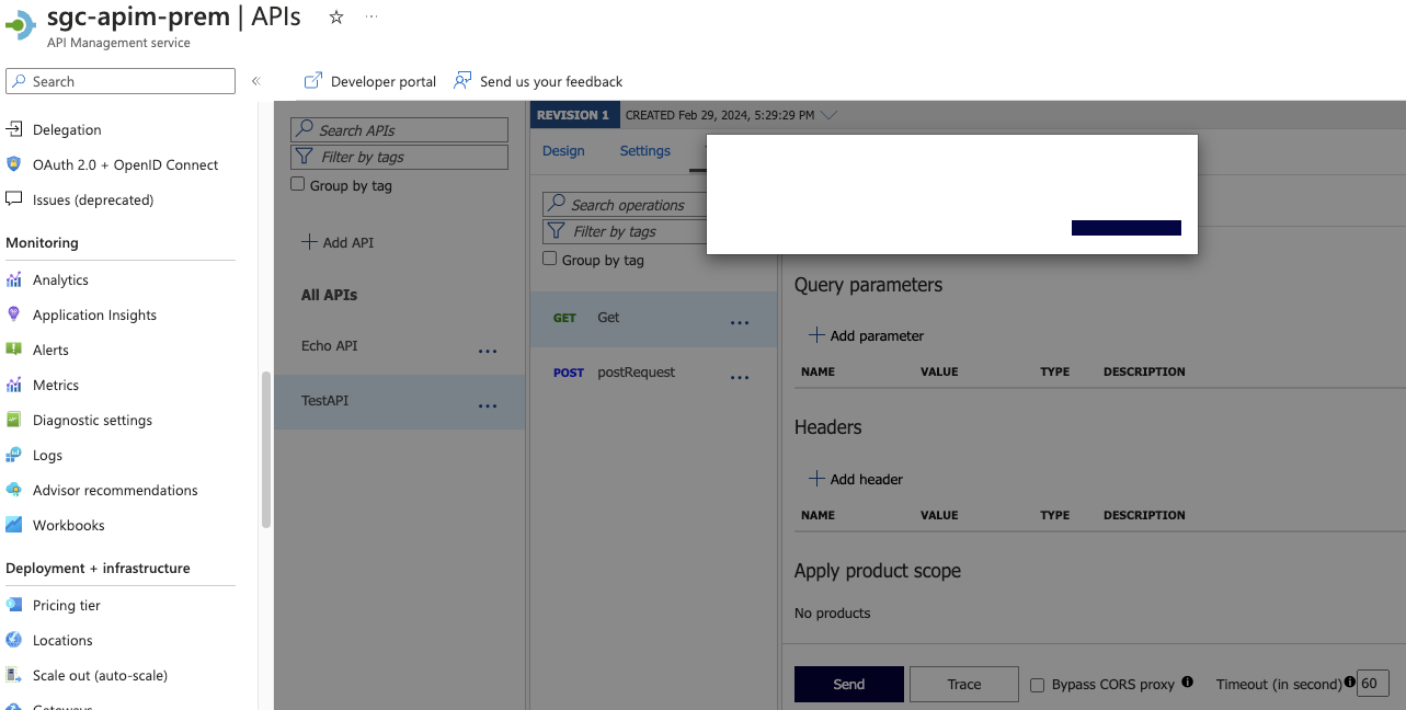

but I get 404 instead (even whil trying inside APIM portal) User's image
What do I do wrong? Do I need to configure the GW exposed IP somewhere? When I click on "Trace" I just get this empty screen:User's image

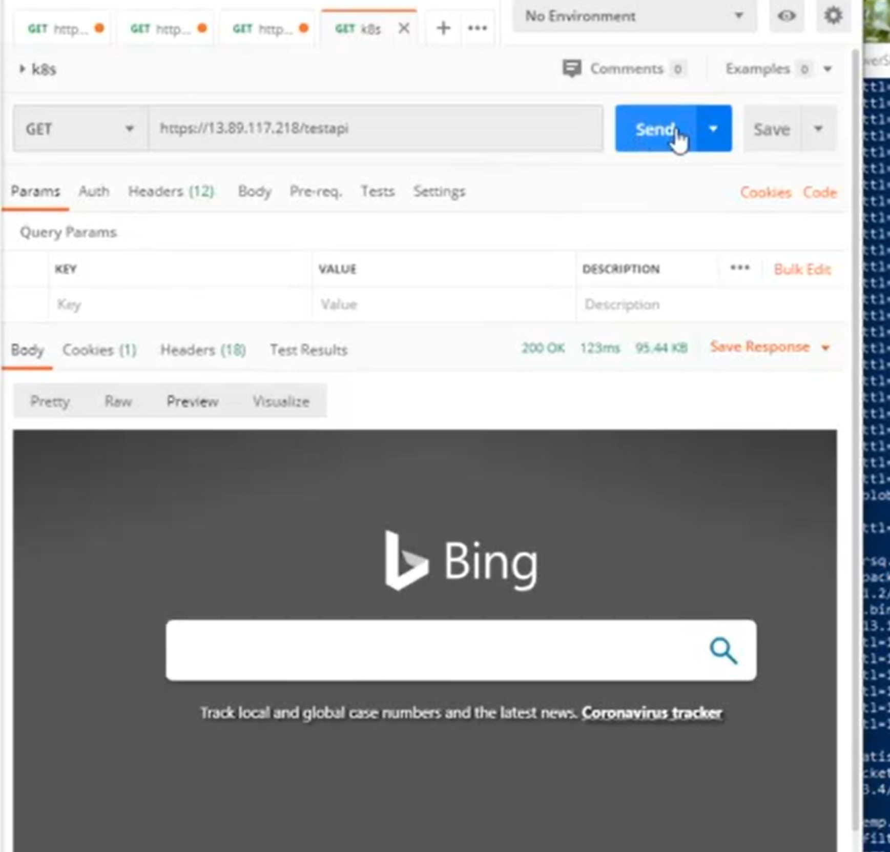

    @David Macháček Thanks for getting back, this will not work from portal test console as i see from the screenshot that you're making a call to http://sgc-apim-prem.azure-api.net/request the host name gc-apim-prem.azure-api.net will resolve to Ip address of your APIM instance. Can you please try with postman as below with AKS ip address.
    By this way you can verify that the self-hosted gateway is configured correctly, and that the API is accessible through the SHG.
