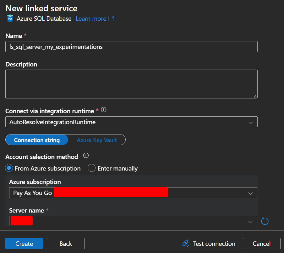

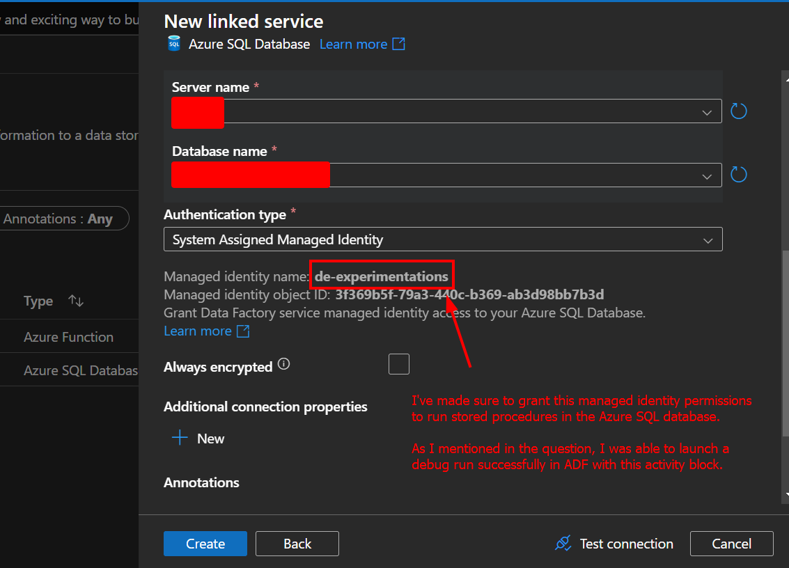

I was able to create Linked Service to Azure SQL DB as shown below, and was able to test the connection and run a stored procedure in it successfully using an Azure Data Factor (ADF) activity shown below.
    "name": "ls_sql_server_my_experimentations",
    "properties": {
        "description": "Linked service for Azure SQL Server resource, 'my-experimentations'.",
        "annotations": [],
        "type": "AzureSqlDatabase",
        "typeProperties": {
            "connectionString": "Integrated Security=False;Encrypt=True;Connection Timeout=30;Data Source=my.database.windows.net;Initial Catalog=my-experimentations"
But when I try to save the pipeline that contains the activity above (JSON representation below):

Screenshots below show how the linked service looks in ADF UI.
1
2
If anyone has resolved such an issue in the past, I'd greatly appreciate if you could share how. Thank you!
