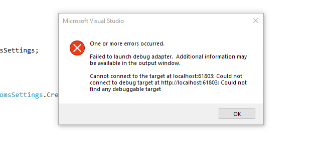

I am running an HTML page in Microsoft Edge from a VS 2022 (say it instance 1).
In another VS 2022 (say it instance 2), I have attached a debugger to the MS Edge process that is running my HTML page. The html page URL is like this: [http://localhost:61028/WebResources/BulkAddress.html]
When I am hitting a button from my HTML page, it tries to debug code of C# in instance 2 of VS 2022. But at this stage, it throws error like this
Failed to launch debug adapter. Additional information may be available in the output window.
Cannot connect to the target at localhost:61803: Could not connect to debug target at http://localhost:61803: Could not find any debuggable target
In the error above, you can see it is mentioning port 61803 which is different from the actual HTML page running in Edge. Why is it taking a different port, even though I have attached the correct process for MS Edge with port 61028?
So, I am unable to debug my code. Any idea?
This is error I am facing when I press the button to debug
Thanks

    Hello @Muhammad Fasih Akbar ,
    Thank you for taking time to post this issue in Microsoft Q&A forum.
    Please try to close your project and Visual Studio, navigate to your solution folder, find and remove/rename the hidden .vs folder then rebuild and run your project again, after that attach the debugger and check if this issue disappears.
    Best Regards,
    Tianyu
