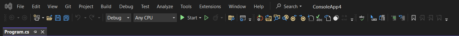

I noticed that the debug button stated "Start" on it instead of "Windows Local Debugger".
You created several projects for test, some might be based on .NET Framework, some might be based on .NET.
.NET and .NET Framework are different(detailed differences, see this document: What is the difference between .NET and .NET Framework?), so some behaviors or displays you see in Visual Studio, or when you are debugging, are a little different. But they are all correct.
For example, sometimes when you are going to debug, you may see "Start", or "ConsoleApp4"(your project name), or "Local Windows Debugger". Sometimes more debuggers can be selected(Remote Windows Debugger/Web Browser Debugger/Web Service Debugger…).
If you try another entry/option/button, the display should be always the same => Debug > Start Debugging/Start Without Debugging.
