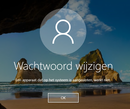

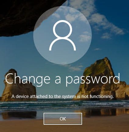

We have one domain controller and serveral RDSH servers and since a couple of months the users can't change their password anymore on the servers. When they are trying to change their password, they get this error (in Dutch) "Een apparaat dat op het systeem is aangesloten, werkt niet". Translated it means "A device connected to the system doesn't work".
We tested changing the password on the domain controller itself via ALT + CTRL + DELETE, but this doens't work either. It gives us the same error.

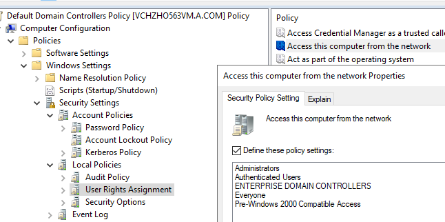

    The Group Policy for the Default Domain Controller Policy was missing the setting for Users group
    • Computer Configuration --> Windows Settings --> Security Settings --> Local Policies --> User Rights Assignment --> "Access the computer from the Network"
    By adding Users to this setting , users of the system are able to change their password at first login. Remove users and the error message "A device attached to the system is not functioning".

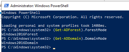

    Please check the functional level by running commands below:
    (Get-ADForest).ForestMode
    (Get-ADDomain).DomainMode
    Please try to raise forest functional level and/or domain functional level, then check the result.

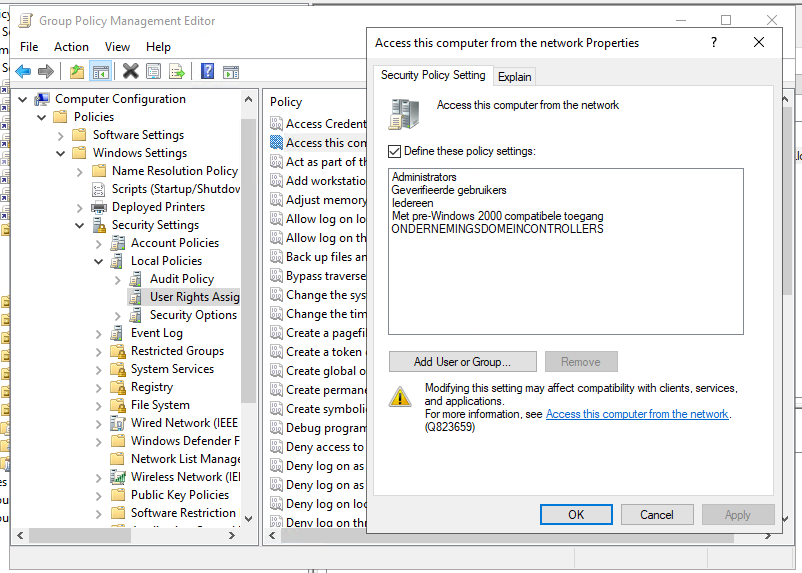

  2. Jos 106 Reputation points
    2024-03-14T08:03:15.02+00:00
    Thanks for the quick response, we have tried what you mentioned, but without luck. This is how it is configured currently.
    We are still getting this error
