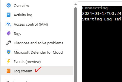

    Kindly post any ouput from the following , and also enable if available the file system logs
    aqa
    aqa2

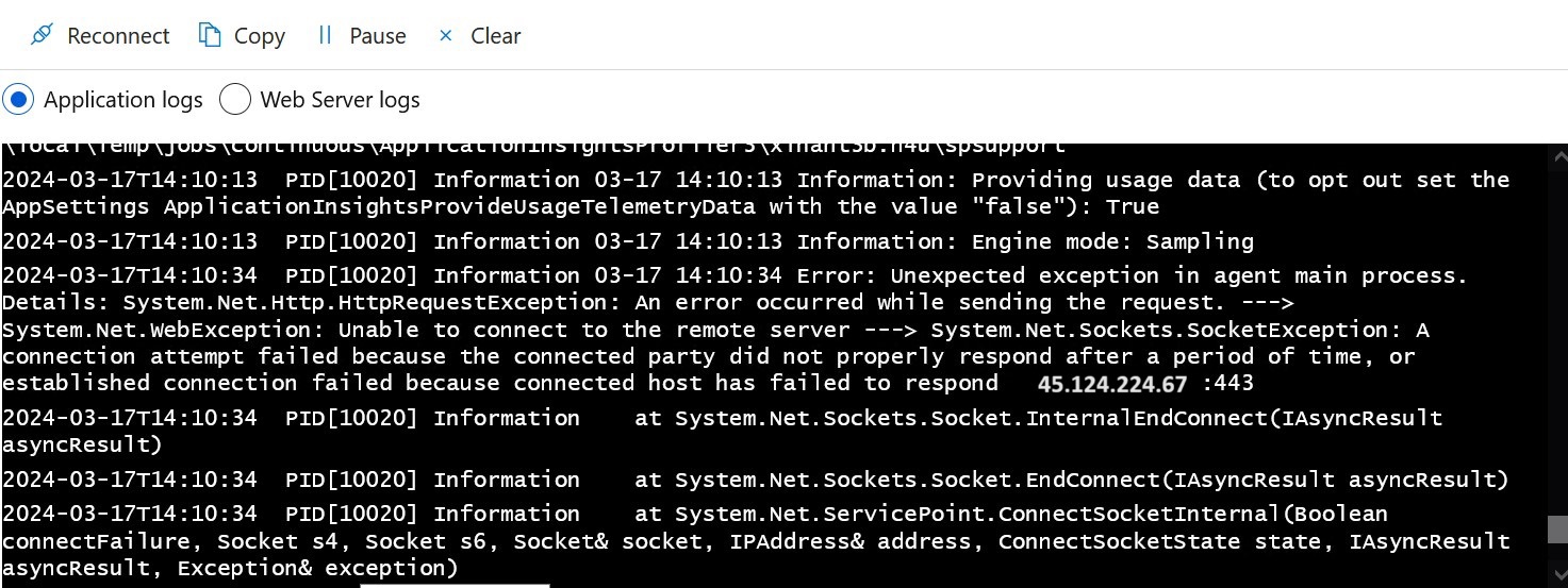

    2024-03-18T14:25:41.78+00:00
    error
    Please find the screenshot
  4. Ali, Jaleel 20 Reputation points
    2024-03-19T05:00:04.72+00:00
    Looking at the above screenshot shows, there is a communication problem between App Service and App Insights service. Apparently, the issue was , the firewall was blocking the communication. Allowing this communication to go through the firewall fixed the issue. Thank you @Konstantinos Passadis for the help. Appreciate it.
