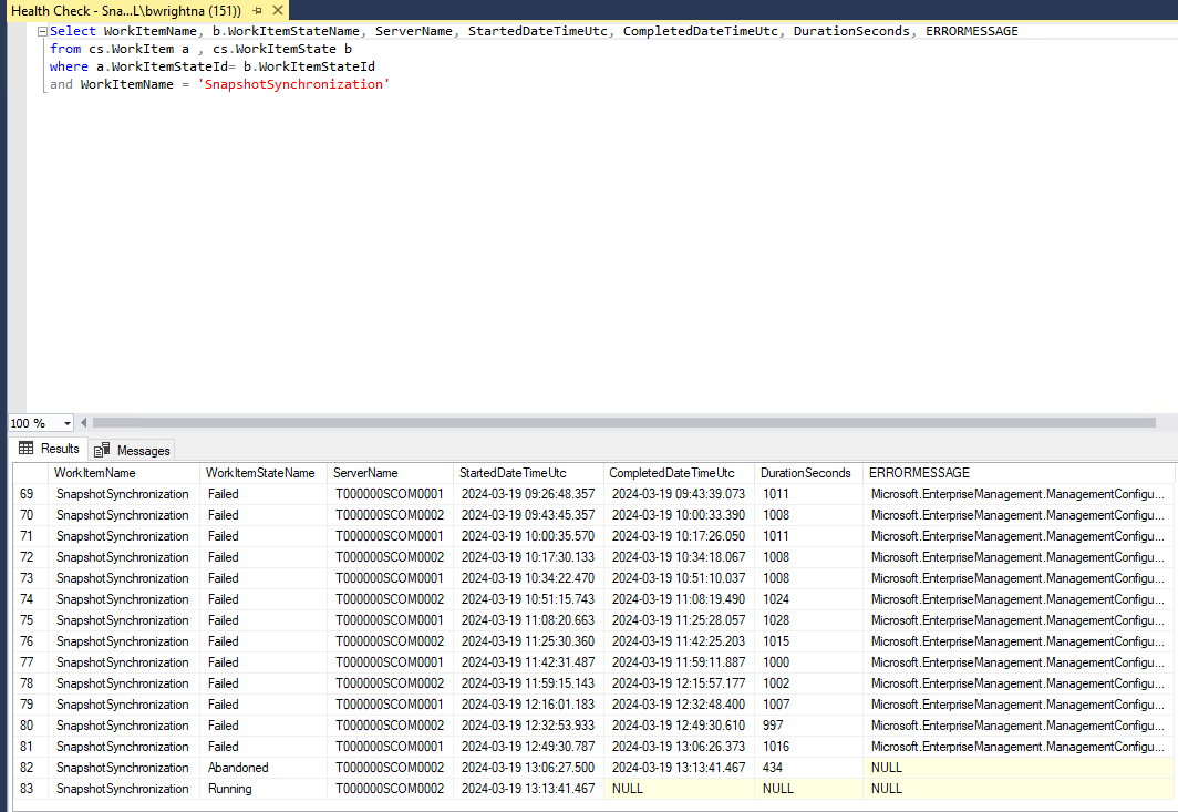

snapshot syncronization keep failing after upgrade to SCOM 2022 R2
Brian W 126 Reputation points
2024-03-19T13:18:45.7633333+00:00
Over the weekend I upgraded my SCOM 2019 U4 environment to SCOM 2022, everything seemed to go OK, but I'm getting these alertsUser's image
When I checkin on the syncronization job in SQL
The abandoned one is when I shut down and flushed SCOM from that MS
Microsoft System Center | Other
  1. XinGuo-MSFT 22,246 Reputation points
    2024-03-20T09:10:54.46+00:00
    I guess your configuration service jobs / stored procedures are failing to execute.
    1. Ensure your SQL is up and running and is not overloaded.
    2. Verify from when this issue is occurring and revert all the changes you did from then.
    3. Delete unwanted management packs which you do not want.
    4. Try to reduce the batch size of the SCOM configuration reducing it from the config file on all the MS as in the below link:
    Configuration isn't updated and event ID 29181 is logged in System Center Operations Manager
    https://learn.microsoft.com/en-us/troubleshoot/system-center/scom/configuration-not-updated-with-event-29181
