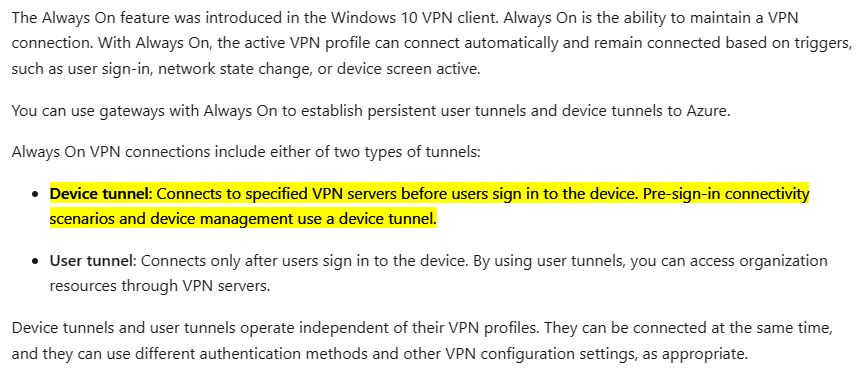

    If I understand correctly, you would like to setup Always On VPN connections using Azure VPN which can connect to specified VPN servers before users sign in to the device. Please confirm if my understanding is correct.
    Always On VPN connection provides Device tunnel which connects to specified VPN servers before users sign in to the device. Pre-sign-in connectivity scenarios and device management use a device tunnel.
    Refer: https://learn.microsoft.com/en-us/azure/vpn-gateway/vpn-gateway-howto-always-on-device-tunnel
    Unlike user tunnel, which only connects after a user logs on to the device or machine, device tunnel allows the VPN to establish connectivity before the user logs on.
    Device tunnel can only be configured on domain-joined devices running Windows 10 Enterprise or Education version 1709 or later. There is no support for third-party control of the device tunnel. If only a Device Tunnel is used on a system, you can configure a Name Resolution Policy table (NRPT). If a User Tunnel and a Device Tunnel are used on a system, you can use the Name Resolution Policy table (NRPT) only on the User Tunnel. Device tunnel does not support Force tunnel. You must configure it as Split tunnel.
