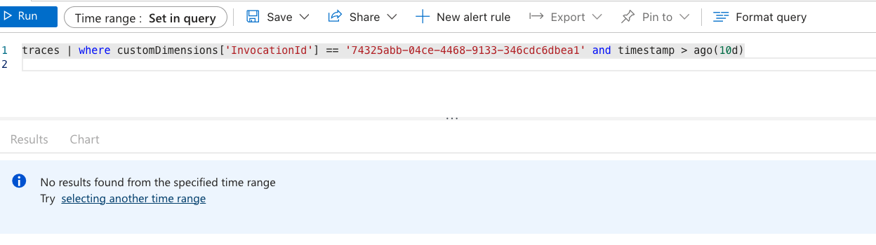

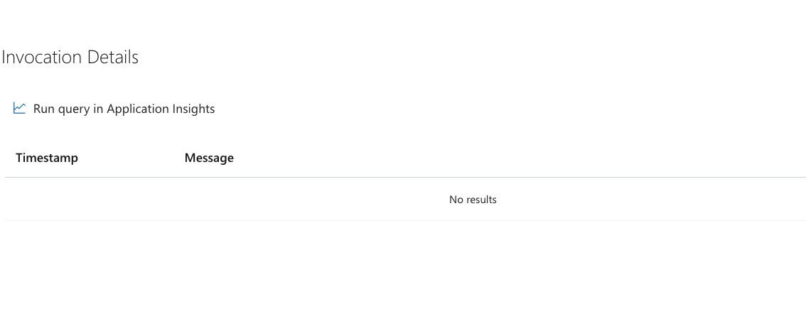

Hello!
Is there a reason for missing logs in a function app? for some requests the logs are visible, but sometimes they are not shown so I'm wondering what could affect the function logging so that no results are shown. Screenshot 2024-03-22 at 11.40.06
Not are functions are affected but one service bus trigger that is quite heavily loaded and receives requests night time

  1. Deepanshu katara 16,565 Reputation points MVP Moderator
    2024-03-28T09:37:20.6333333+00:00
    Hi Zainab,
    Issue -->logs were missing from Azure monitor
    Solution--> Adding this to sampling Settings in host.json file resolved the issue
    "samplingSettings": {
            "isEnabled": true,
            "excludedTypes": "Request;Trace"
    For more details, please check this doc https://learn.microsoft.com/en-us/azure/virtual-wan/how-to-virtual-hub-routing
    Please remember to "Accept Answer" if any answer/reply helped, so that others in the community facing similar issues can easily find the solution.
    Thanks,
    Deepanshu
