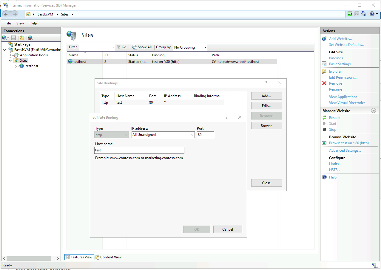

Host name is specificied in IIS managerUser's image

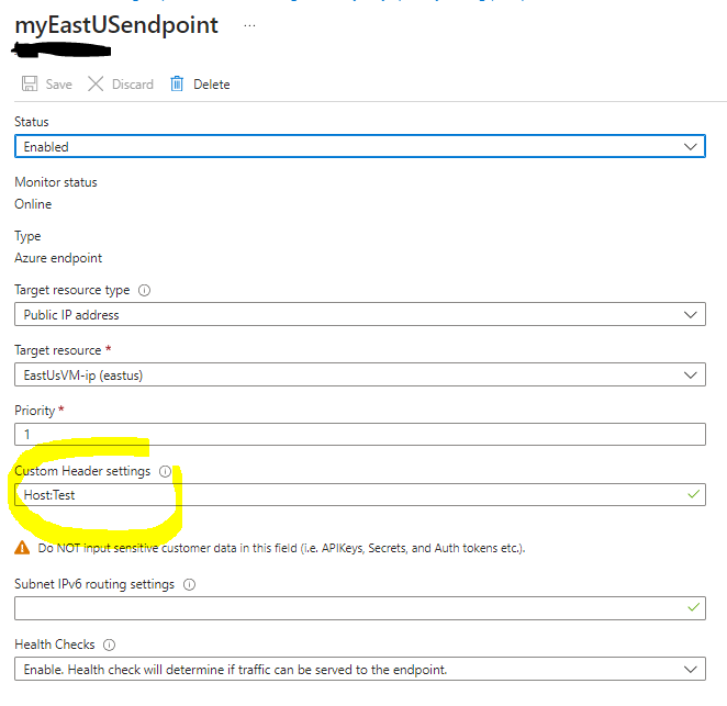

I added this host information at endpoint level.

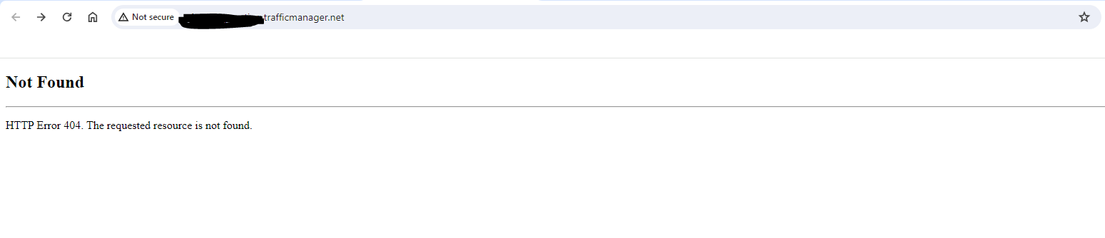

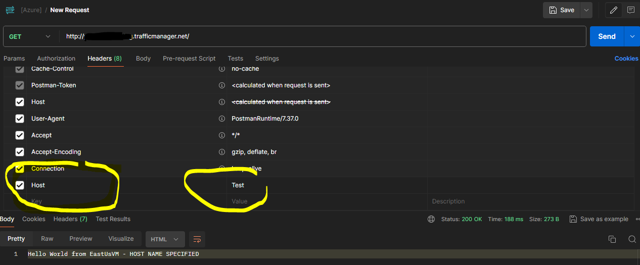

It returns the right result when I tested in postman
However browsing the traffic manager in browser was unsuccessful.

    • You added Host Binding to your IIS VM.
    • This means, requests to IIS VM would expect the host to be "Test"
    • And other host or directly accessing via IP Address would give you 404 (not Traffic Manager, the IIS VM itself would give you 404)

    • Custom header settings is only for endpoint monitoring, i.e., Health check ups from Azure Traffic Manager to your IIS VM.
    • Not for actual customer traffic to your IIS VM. See : ATM Endpoint monitoring
    • This means, the header Host:Test is only sent when ATM probes for health of the IIS VM, not when a customer tries to access the IIS VM.

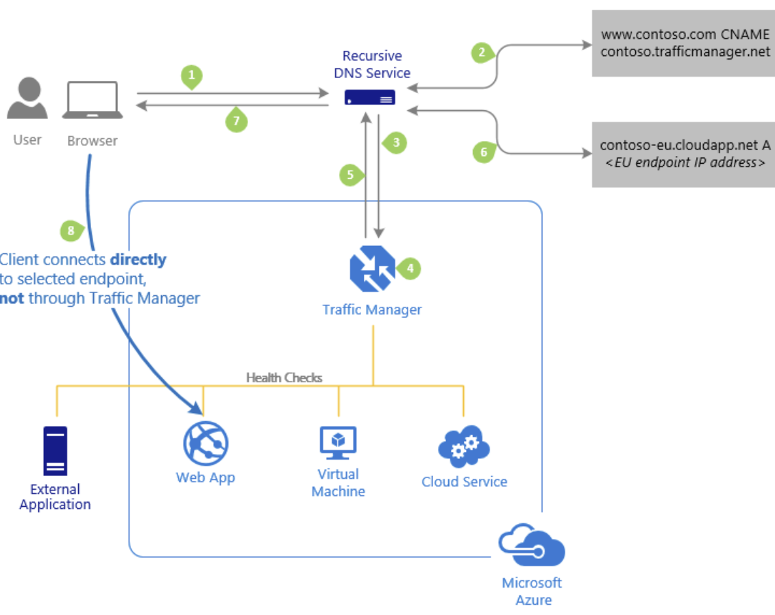

    • Also, customer traffic never passes through a ATM. This means, there is no way you can influence the HTTP Headers of a client request using ATM.
    • See : How clients connect using Traffic Manager.
    • User's image
    So, when a custom requests goes to the VM, it will not have the header Host:Test and hence, the IIS VM would return a 404.

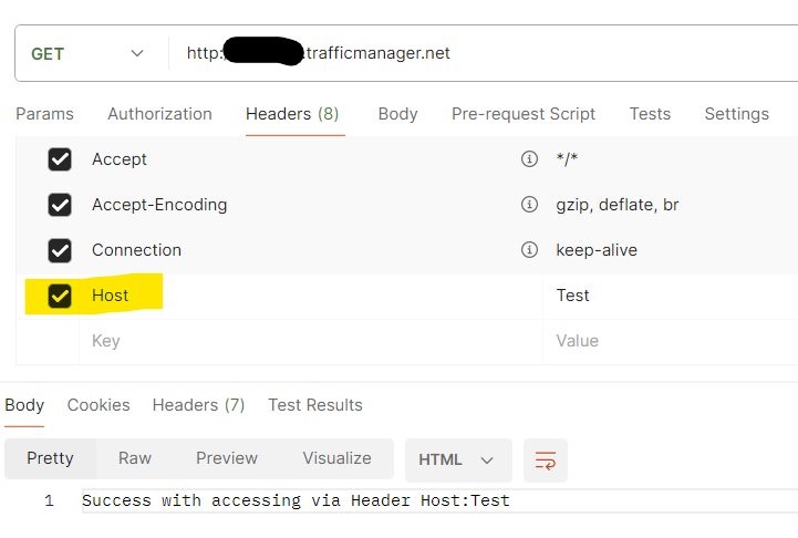

    • The reason it is working with PostMan is that you are manually sending the header Host:Test with your request (per your screenshot)

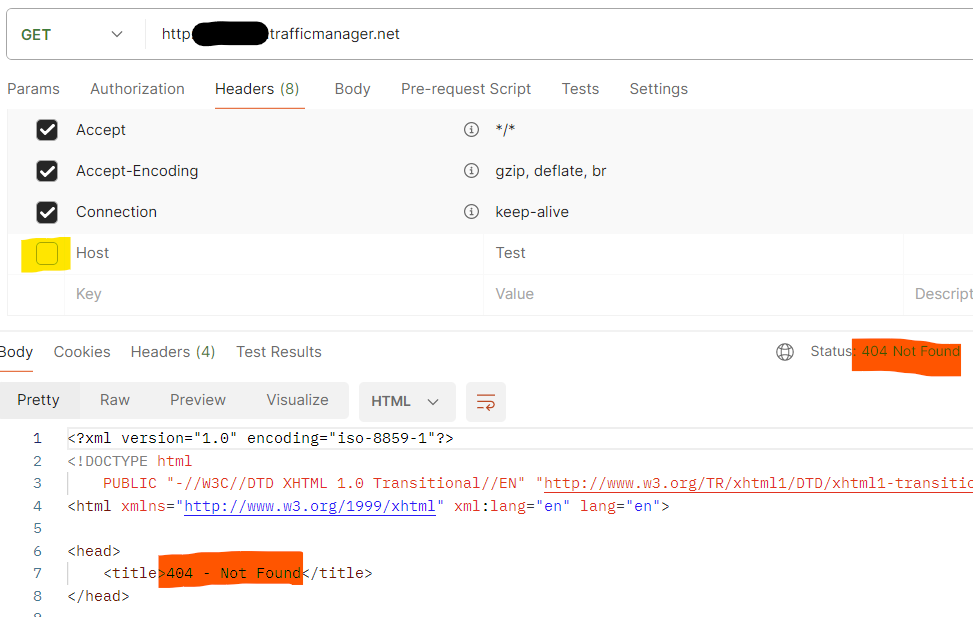

    • User's image
    • If you were to remove the Host header, this will also give 404 only (just like a Browser, because when you access the site via Browser, the Host header is not added by anyone)
    • User's image
