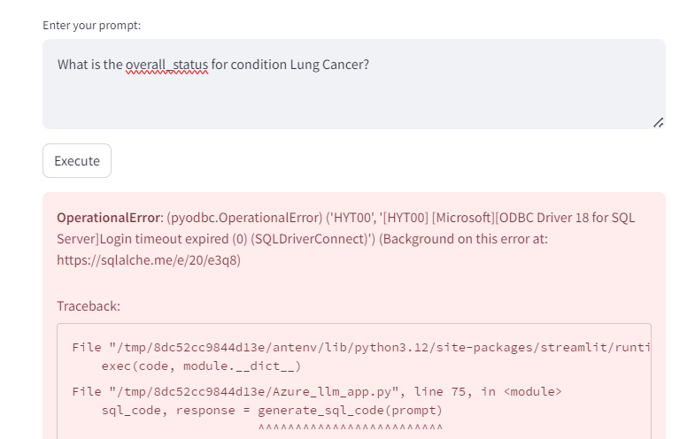

I have a SQL LLM streamlit app deployed in Azure App Service. We give it a prompt, and the llm generates sql code. The LLM data source is Azure SQL Database. When I run this application locally (without deploying) it works fine, however after deploying in Azure, I keep getting this error:
Please help me and thanks.

    Based on the error message you have shared, I think there is an issue with the connection between your Azure App Service and the Azure SQL Database.
    Verify that the connection string used by your application in the Azure App Service is correct and includes all necessary parameters. Sometimes, configurations that work locally might not be suitable for cloud environments due to differences in networking or security settings.
    If you are using a Managed Identity for authentication, ensure that it is properly configured and has the necessary permissions to access the Azure SQL Database.
    Or, if your Azure SQL Database is inside a virtual network, you may need to verify the VNet Integration for your Azure App Service.

  2. Sai Supriya Vadali 50 Reputation points
    2024-04-10T03:16:26.2866667+00:00
    Hello,
    Providing the SQL DB's password fixed the issue for me.
    Thanks

    Scenario: Developed a SQL LLM streamlit application, which is deployed on Azure App Service. This application takes prompts from users and generates SQL code using the LLM. The data source for the LLM is an Azure SQL Database. The application works perfectly when run locally, but after deployment on Azure WebApp, it encounters an error.
    Issue:
    After deploying the SQL LLM streamlit app on Azure App Service, encounter the following error when providing prompts:
    Enter your prompt: "Posted a relevant prompt/question"
    Error: OperationalError: (pyodbc.OperationalError) ('HYT00', '[HYT00] [Microsoft][ODBC Driver 18 for SQL Server]Login timeout expired (0) (SQLDriverConnect())') Background on this error at: https://sqlalche.me/e/20/e3q8
    Solution:
    @Sai Supriya Vadali confirmed and shared the solution that worked - thank you!
    Providing the SQL DB's password fixed the issue.
