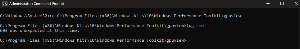

After this when I run this log.cmd I got error
603 was unexpected at this time.
This seems to be something syntax error? Or is this something else? Is there option run this log.cmd line by line to see where this error comes?
What is needed to do fix this?
And I am running CMD as Administrator rights.

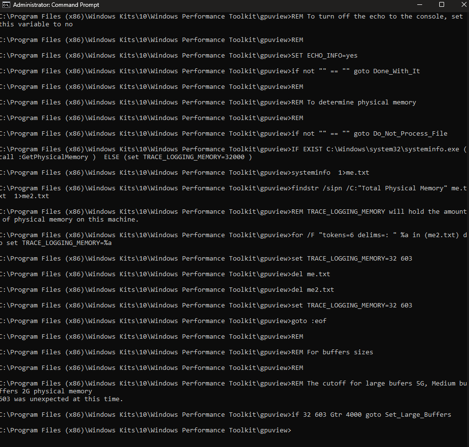

  1. Gary Nebbett 6,436 Reputation points
    2024-04-11T14:17:35.3166667+00:00
    Hello Hoikkari-2301,
    The "problem" is that the space character has been set as the "digit grouping symbol" in the regional settings. The number 32603 is displayed as "32 603". The log.cmd script can cope with a comma (",") as the grouping symbol but it does not handle the other common symbols (dot, apostrophe and space).
    Gary

  2. Gary Nebbett 6,436 Reputation points
    2024-04-10T10:14:09.4366667+00:00
    You could try making a copy of log.cmd (e.g. copy to testlog.cmd) and then editing the copy to remove or disable the @echo off command on the first line. Then run the new cmd file.
    Gary
