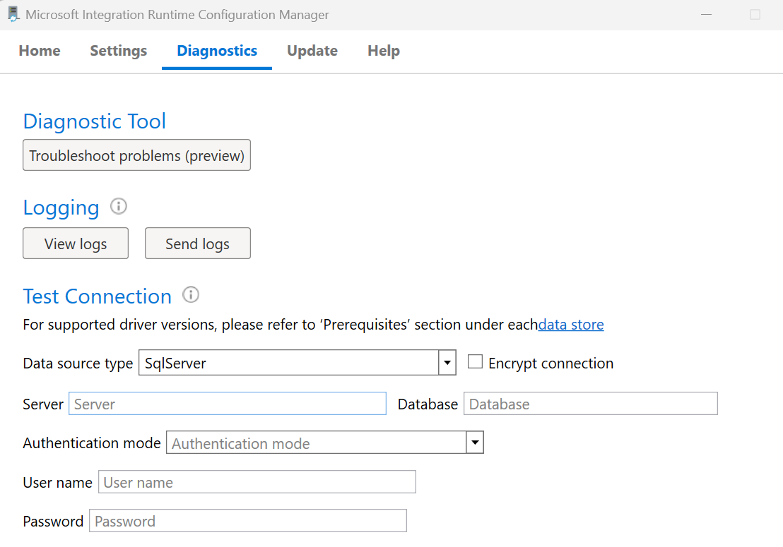

    Please try to connect to the SQL Server via the SHIR UI’s diagnostic tab and see if you can be able to reproduce the connectivity issue.
    If the SHIR is behind a firewall, please work with your network admin so that it can communicate with the SQL Server.
