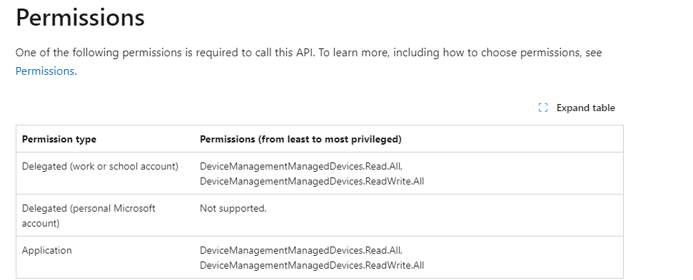

    @Supriya Kulkarni For this api, the following permission is enough:
    https://learn.microsoft.com/en-us/graph/api/intune-devices-manageddevice-list?view=graph-rest-1.0&tabs=http

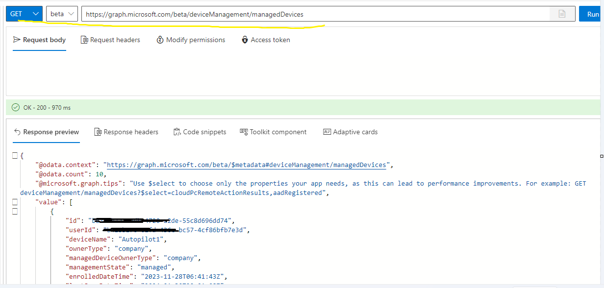

    For this issue, I have done the test. I use the following request to get all the devices. It works.
    https://graph.microsoft.com/beta/deviceManagement/managedDevices

    @Supriya Kulkarni, Thanks for posting in Q&A. From your description, I know the permission is granted. But it still gets 403 permission issue. Based on my testing, I find it is working in my lab when grant the following permission.
    DeviceManagementManagedDevices.Read.All, DeviceManagementManagedDevices.ReadWrite.All

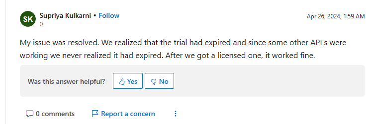

  3. Supriya Kulkarni 0 Reputation points
    2024-04-25T17:59:58.5866667+00:00
    My issue was resolved. We realized that the trial had expired and since some other API's were working we never realized it had expired. After we got a licensed one, it worked fine.
