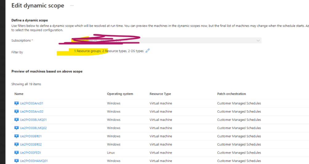

  4. Suppose I will create new VM, and if I want that VM to be part of existing maintenace configuration, I should use dynamic scope, am I correct?

    4. Suppose I will create new VM, and if I want that VM to be part of existing maintenance configuration, I should use dynamic scope, am I correct? - If you use direct assignment or dynamic scope it is up to your preference. Dynamic scope allows to put VMs into maintenance configuration dynamically (based on subscriptions, tags, locations, etc.) without having to do specific assignment every time a new VM is created.
