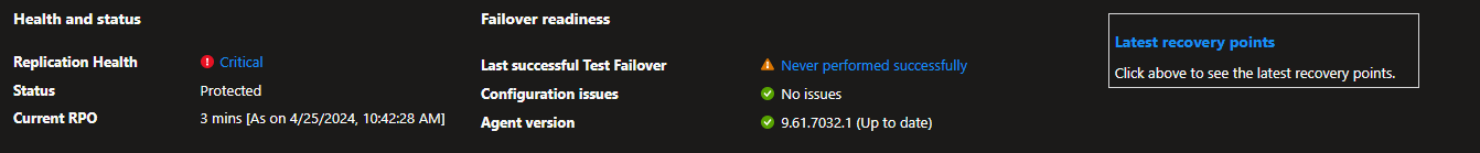

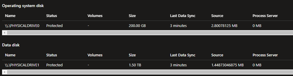

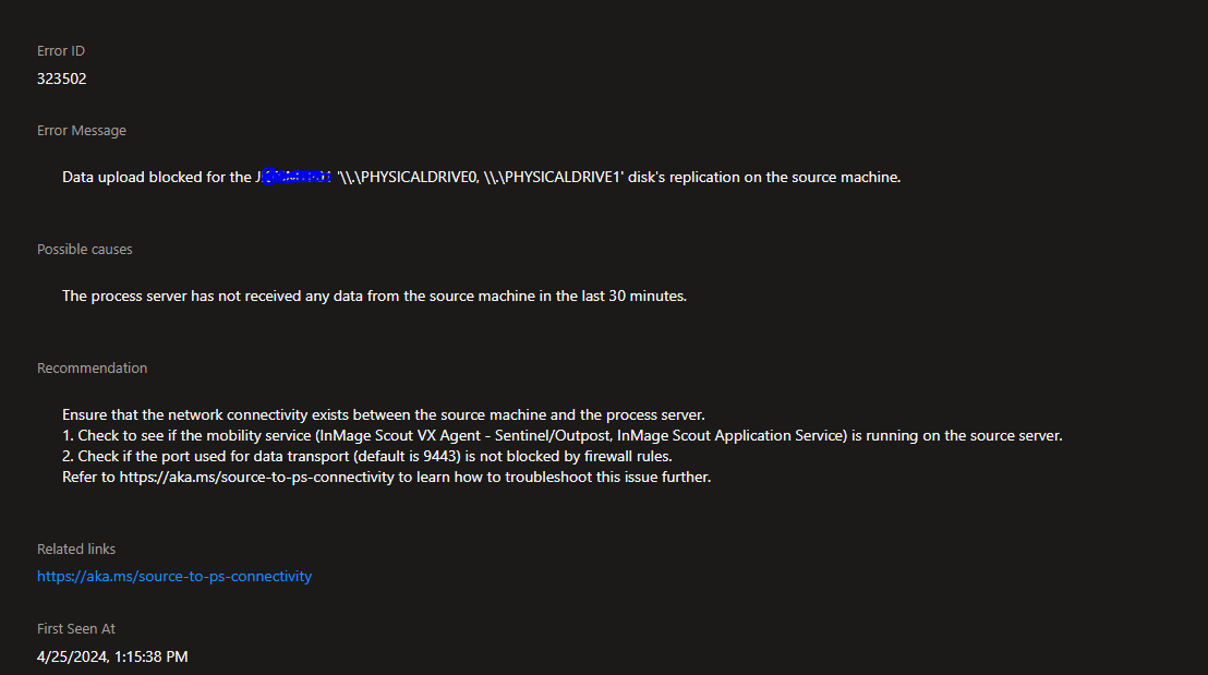

I have 3 server replicated to azure via ASR, one of them always have error 'Data upload blocked for the SERVER-1 '\.\PHYSICALDRIVE0, \.\PHYSICALDRIVE1' disk's replication on the source machine.'.
Even have this error and the replication health is critical but the RPO is up to date
Someone can confirm in this condition, the server is replicated or not? And how to resolve the health status?

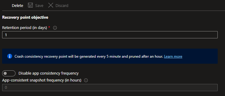

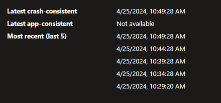

    Based on the information provided, it seems that there might be an issue with the replication status of a server, possibly related to application consistency. The "latest recovery points" page is typically used to confirm the replication status, and from the screenshot, it appears that application consistency is not available.
    One possible scenario for this error is that application consistency might not be enabled for the replication policy. This could lead to errors such as "Data upload blocked for the SERVER-1 '.\PHYSICALDRIVE0, .\PHYSICALDRIVE1' disk's replication on the source machine."
    Another consideration is the possibility of high data change rate (CHURN), which can lead to intermittent generation of restore points. It's suggested to double-check the error message's timestamp and compare it with the restore point's timestamp for further investigation.
