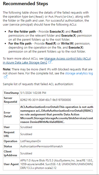

Operation failed: "This request is not authorized to perform this operation using this permission.", 403, GET, https://[REDACTED].dfs.core.windows.net/lake?upn=false&resource=filesystem&maxResults=5000&directory=[REDACTED]&timeout=90&recursive=false, AuthorizationPermissionMismatch, "This request is not authorized to perform this operation using this permission. RequestId:82f621f0-301f-004f-60c7-9b5197000000 Time:2024-05-01T13:02:06.8819444Z"

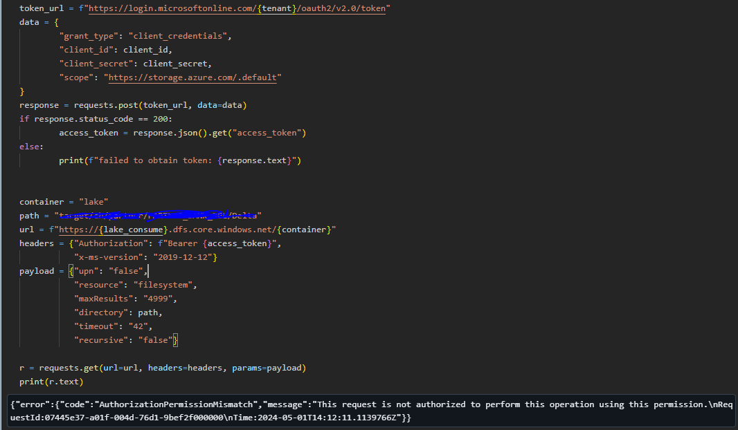

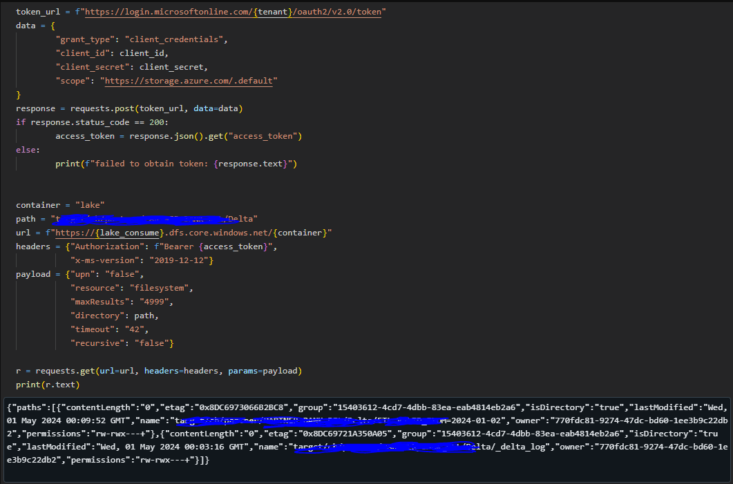

I was able to replicate the API call that Databricks does on the background while writing to Delta, and it is simple GET that already fails while run as SP that is authorized with ACL:User's image If run with SP authorized with RBAC it works fine:User's image

After running MS diagnostics on Azure, recommendation is indeed something that I already have, but failure shows it is denied because RBAC is missing, so this operation seems not to coincide with security model of MSFT (where ACL should be also evaluated after RBAC), see:

    As you mentioned that the writing happens correctly for the first time, can you let me know what are the permissions on that file at the time of over-writing and the Mask permission? If it w.r.t. overwriting, one need at least Write (W) permission on destination file. If the write permissions are there, then we need to look at the Mask permission if it has write permission as well. If not, then the call might tend to fail.
    However, based on the snippet that you shared w.r.t. Diagnostic information, the failing call is for ListFileSystemDirectory operation which will not need write permission as it is a listing operation.

    "Writer SP" with ACL, let's call it ch-ETL-runner writes for the first time to empty Delta directory partition dirs and delta log dir together with snappy paquet files and delta log files. Without any problem. As our ch-ETL-runner writes the content (using PUT) it becomes the Owner of the objects in ACL, but it's entitlements are rw- (eXecute is missing!). Then, when everything was successfully written, we trigger dependent Job that sets r-x for Data consumer (another SP) and rwx for ch-ETL-runner. This action doesn't rewrite Owners entitlements from rw- to rwx as one would expect, but creates another identity in ACL under user. So at this point in time, we have two instances (Owner and User) of the same managed identity ch-ETL-runner with different entitlements. Once second attempt to write to delta happens, sometimes "correct" user identity with rwx is evaluated by security model but sometimes not, when Owner is identified by API, it is missing eXecute and can't perform any action (not even GET).
    Quick-win solution
    When you set ACL programmatically, make sure you always rewrite privilege of Owner as well as user if those by any chance coincide with same identity (like in our case).
