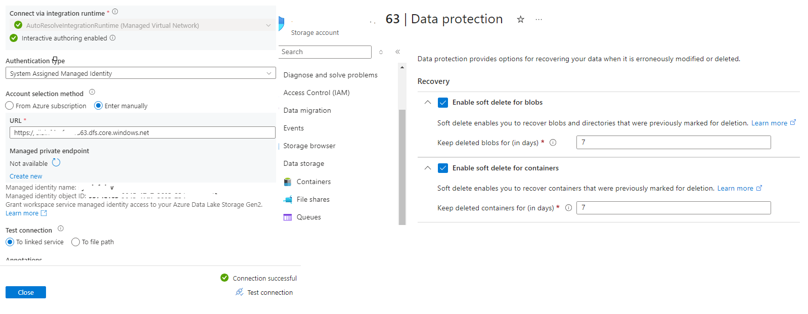

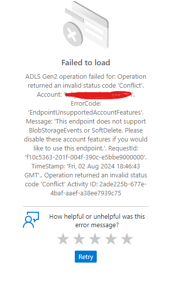

Currently setting up a storage account for a synapse analytics workspace, there is an existing synapse workspace with a linked service to an azure storage account, When I tried to setup a similar configuration I get the error message below.
1
Here it doesnt work
2

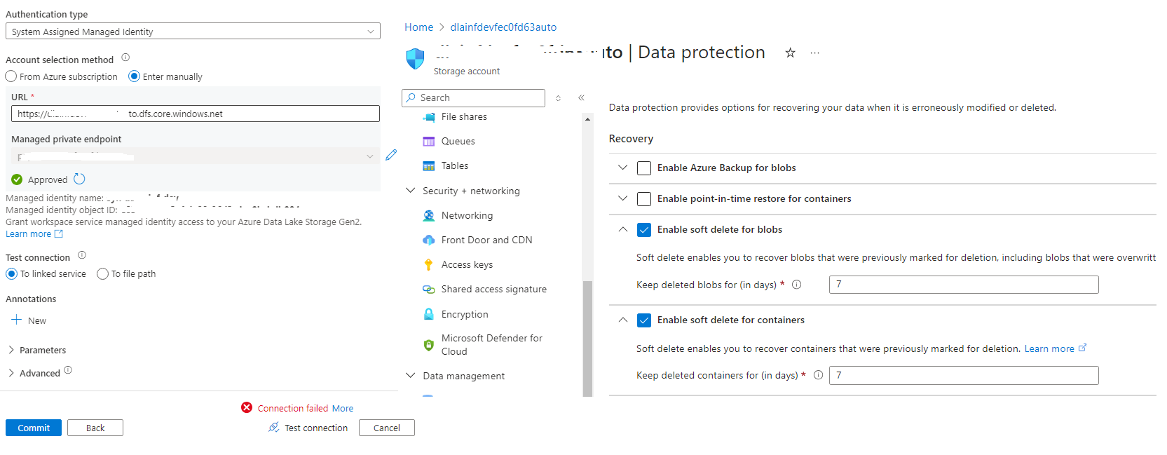

If I disable soft delete for containers and blobs, the test connection functionality works, but the moment I enable it, it fails.
What worries me is this, within one of our other environments soft delete for containers and blobs is enabled and the connection works, setup with a managed identity, this was done over a year ago, but If I try to do that today with a new configuration it doesnt work. Not sure what i am supposed to do here.

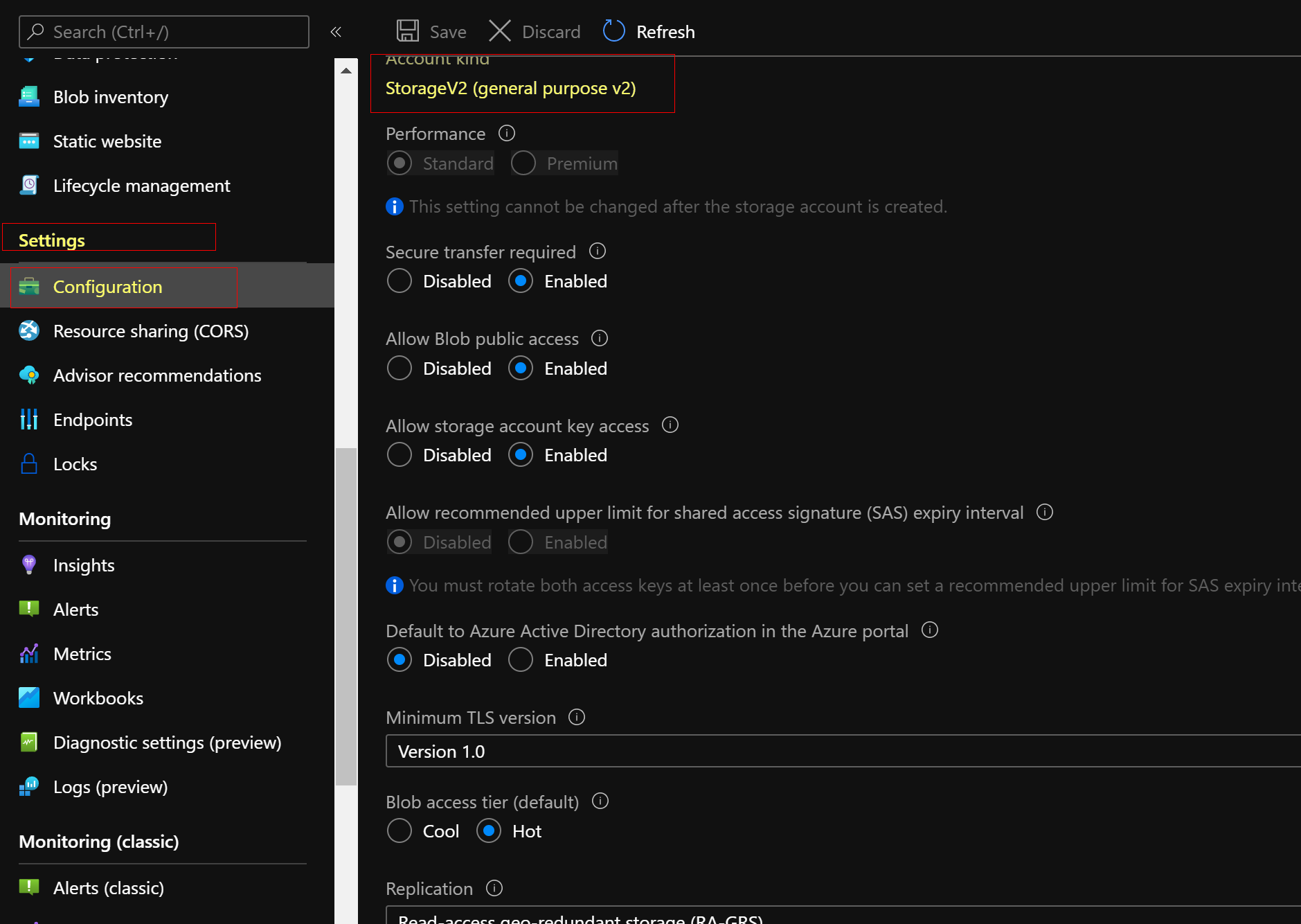

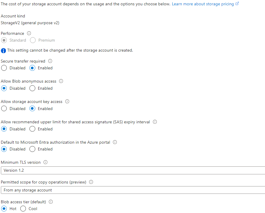

    The “Conflict” error indicates that there’s a conflict between the configuration you’re trying to set up and the capabilities of the storage account. Could you please double check if your storage type is General purpose V2? You can go to Storage account Settings and under Configuration section you can find these details. Please see below image for reference:

    The first account in the snippet appears to be an ADLS Gen2 account and you are using a DFS endpoint which will tend to work.
    The second account in the snippet appears to be a non ADLS Gen2 account and is a standard GPv2 account. You are using a DFS endpoint with that one and that particular combination along with soft delete isn't supported one and hence the failure.
    You can either use ADLS Gen2 account or you make use of blob endpoint i.e. AccountName.Blob.Core.Windows.net instead of DFS one.
