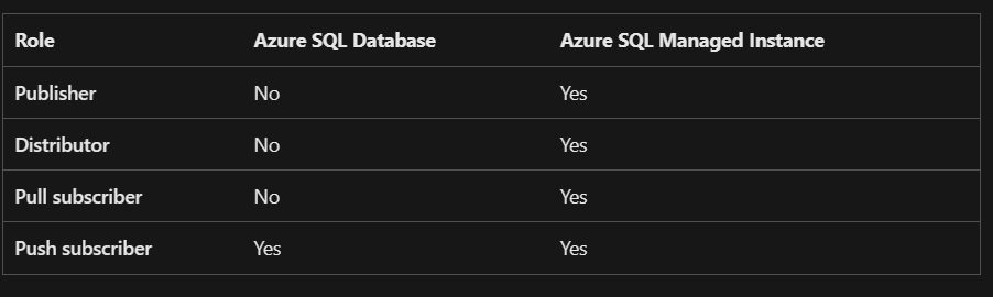

  2. MikeyQiaoMSFT-0444 3,300 Reputation points
    2024-05-17T05:54:03.63+00:00
    how about a Azure SQL Managed Instance
    Azure SQL Managed Instance has less limitations and more roles.
    Publisher and Distributor can be on prem server and still we can have pull on the subscriber.Please confirm.
    The Publisher publishes changes made on some tables (articles) by sending the updates to the Distributor. The publisher can be an Azure SQL managed instance or a SQL Server instance.
    The Subscriber receives changes made on the Publisher. A SQL Server instance and Azure SQL managed instance can both be push and pull subscribers,though a pull subscription isn't supported when the distributor is an Azure SQL managed instance and the subscriber isn't.
    So you can configure Azure SQL Managed Instance as a pull subscriber.
