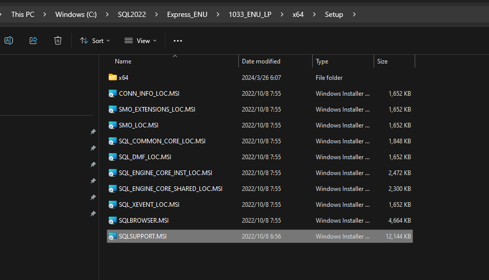

exit code (decimal): -2068052377error description: invalid command line argument. consult the window installer sdk for detailed command line help
Dukanhh 40 Reputation points
2024-05-29T14:08:19.1766667+00:00
This morning I was still able to use sql, I was curious and deleted something like SQLEXPRESS16, then I uninstalled all sql and reinstalled it all, and used quite a few cmd commands that I didn't know to uninstall but still nothing. I can't remove them, and now what should I do, they are too difficult for me. Please help me as soon as possible, I have a test coming up on June 11 and I need to practice them.
