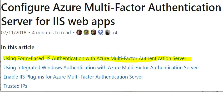

  2. Kani 61 Reputation points
    2020-11-21T13:30:48.243+00:00
    Thank you @Echo Du_MSFT for the answer. I guess the mentioned approach for "Configure Azure Multi-Factor Authentication Server for IIS web apps" is deprecated from July 2019 as it involves installing the MFA server.
