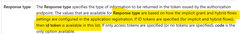

    I am unable to obtain and view a token on https://jwt.ms****.
    When testing the user flow directly from the Entra portal, ensure that you select "id_token" in the response type to receive the ID token, which can then be decoded using jwt.ms.User's image

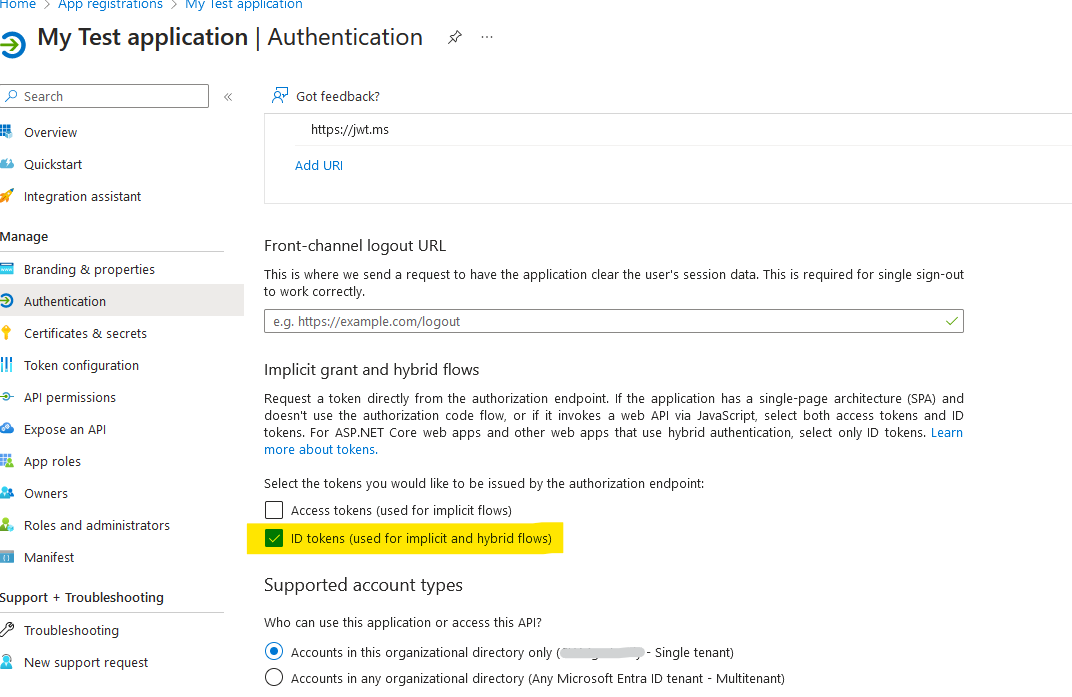

    You need to make sure to configure the implicit grant and hybrid flow settings in your registered application to get the id_token in response type.
    Reference - https://learn.microsoft.com/en-us/entra/external-id/customers/how-to-test-user-flows
