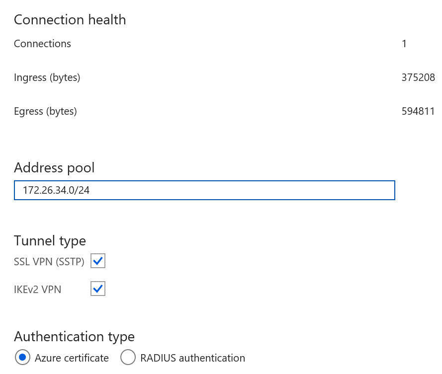

    Hi Zosimo Recio Jr •, Welcome to Microsoft Q&A forum. As I understand, you could not connect to newly created Azure SQL Managed Instance. Could you please let us know the configuration details of the SQL MI ? Also, review your network settings and instance name.
    • If you're unable to connect to SQL Managed Instance from an Azure virtual machine within the same virtual network but a different subnet, check if you have a Network Security Group set up on VM subnet that might be blocking access. Additionally, open outbound connection on SQL port 1433 as well as ports in the range 11000-11999, since those are needed to connect via redirection inside the Azure boundary.
    • Ensure that propagation of gateway routes is disabled for the route table associated with the virtual network.
    • If using point-to-site VPN, check the configuration in the Azure portal to see if you see Ingress/Egress numbers. Nonzero numbers indicate that Azure is routing traffic to/from on-premises.
    Screenshot showing ingress/egress numbers in the Azure portal.
