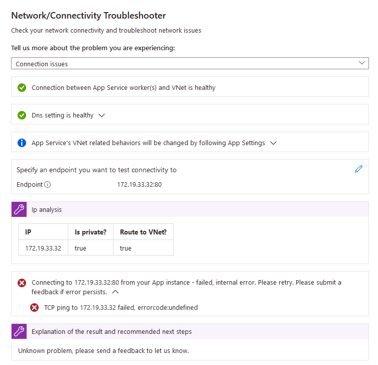

Connecting to 172.19.33.32:80 from your App instance - failed, internal error. Please retry. Please submit a feedback if error persists. TCP ping to 172.19.33.32 failed, error code:undefined
I continue to get this error despite multiple troubleshooting efforts.

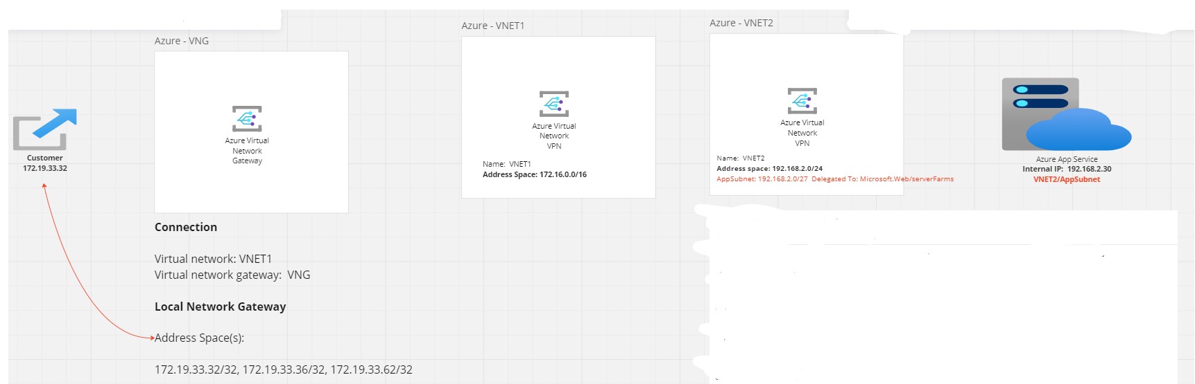

App Service is part of a App-VNET which is Peered with another VNET that connects to customer networks.
Four months ago we could TCPPING the address above successfully.

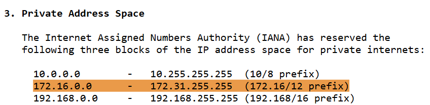

    "172.19.33.32" is not an "external IP" , i.e., not a Public one
    Can you provide more information on this IP?
    • Where exactly does this IP exist?
    • Is it associated to a VM in the same VNET or the Peered VNET
      OR
      A server from OnPremises connected to Azure by VPN or ExpressRoute?
    • There is a high chance that the IP "172.19.33.32" is not listening in Port 80 to begin with
      • How are you confirming that the IP 172.19.33.32 is "still" listening on 80?
      • You can use a VM in the same VNET as the AppService and telnet to 172.19.33.32:80 and test this
    • If possible, please share a network diagram between your App VNET and the destination "172.19.33.32"
