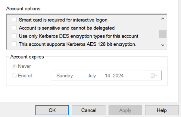

    Please make sure delegation has to set for the middle tier SQL instance service account(VM A). This means that make sure SQL Server service account was trusted for delegation in AD.
    You can go to domain controller -> open active directory users and computers -> users -> right-click the SQL Server Service account in users folder -> Properties. Then go to delegation tab in the Properties dialog box, ensure that "Trust this user for delegation to any service (Kerberos only)" or "Trust this user for delegation to specified services (Kerberos only) – Use Kerberos only "is selected. If you choose the " Trust this user for delegation to specified services (Kerberos only)", please add the SQL Server service. ( please do the same for the delegation tab in the Properties of server's computer object in active directory users and computers.)
    Then go to the account tab in properties and ensure that the "account is sensitive and cannot be delegated" option is not selected.

    As checked in AD, mentioned settings are already in place. As checked at MSSQL end individual connections and query sessions are using kerberos authentication but issue is only while using linked servers.
    **Issue is observed only when I try to connect linked servers on on-premise SQL server from SSMS on Azure VM (Azure virtual desktop) machines
    Queries on same SQL servers and linked servers are executing sucessfully when tried from on-premise VM.**
    I have checked below parameters.
    1. SPN's are registered for all SQL servers.
    2. Delegation is configured for SQL Server service account. In my case one server is using domain account as a service account and all remaining servers are using managed service account.
    3. Delegations are configured for computer objects in AD.
    4. using klist I have checked if kerberos tokens are also generated for the service accounts.
    5. Tried purging kerberos (klist purge) tokens and reinitiating the test connection. It still failed.
    6. On-premise AD servers and Azure AD servers are also in sync.
    7. Property mentioned by you are also in sync.
    8. SQL server logon account is part of local admin group on server.
    9. System time is in sync in all servers and AVD machines.
    Please correct me if I am wrong. The issue doesn't seem to be with SPN and delegation, as the same is working in the on-premise environment.
