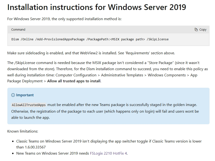

We followed the install instructions found here:
https://learn.microsoft.com/en-us/microsoftteams/new-teams-vdi-requirements-deploy#:~:text=TeamsMeetingAdd%2Din%5C1.24.2203.0%5C%22-,PowerShell,params%0Awrite%2Dhost%20%22Please%20confirm%20install%20result%20in%20Windows%20Eventlog%22,-After%20installation%2C%20restart
It seems to be working as I can see the add-in in Outlook but not long after logging in (Citrix VDI envrionment), the computer then reboots.
I can see in the event logs that it was caused by msiexec.exe initiating the reboot. Anyone else run into this?
