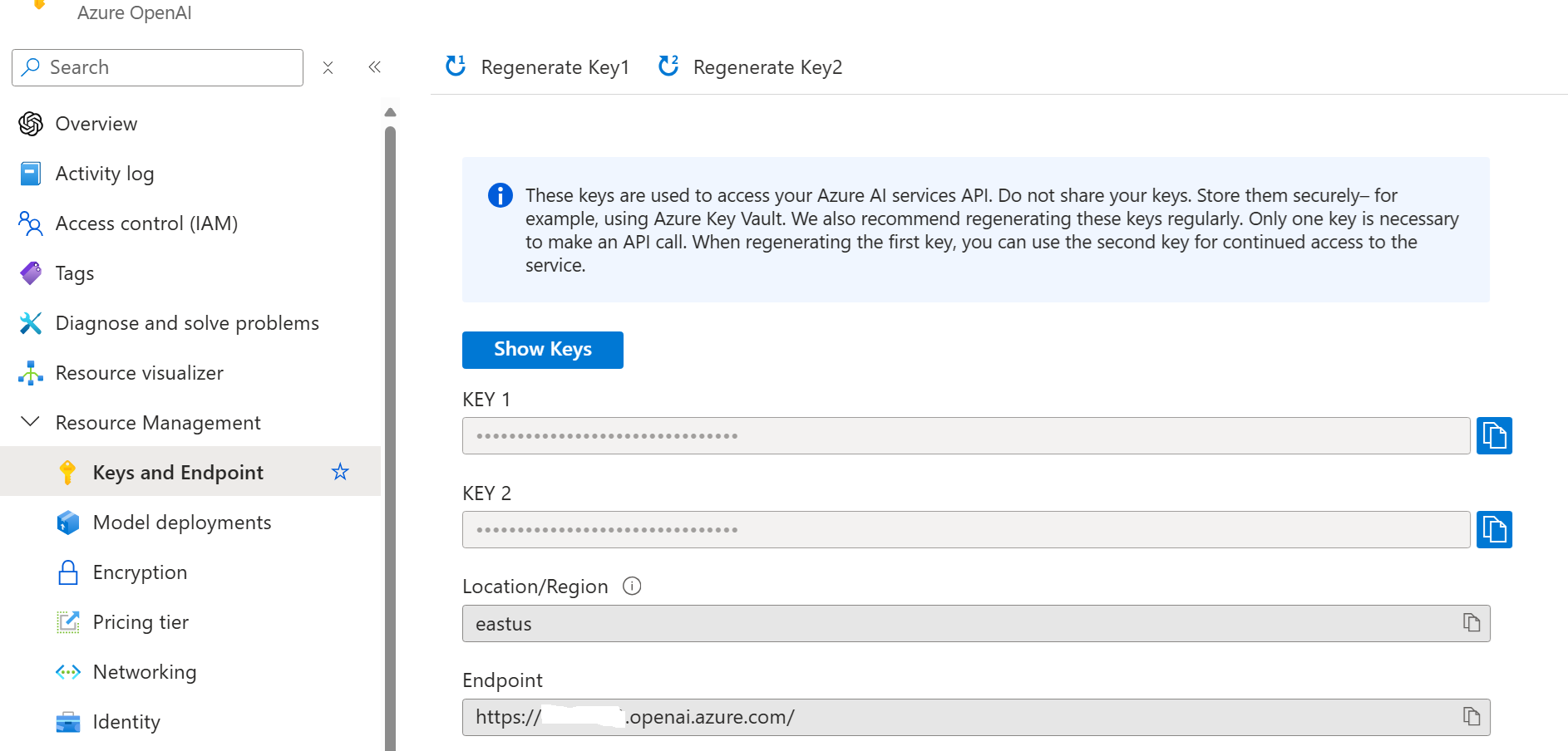

I got the key and endpoint from 'Keys and Endpoint'
Azure OpenAI Service
