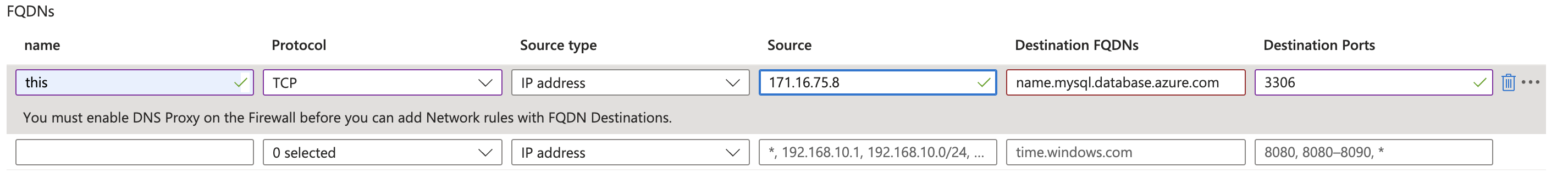

I have an azure managed mysql database in virtual network vnet1 and a virtual machine in vnet2. I am unable to get this VM to access the database. I have a hub-spoke architecture with both vnet1 and vnet2 peered with my hub-vnet with firewall. I am not interested in peering vnet1 and vnet2. I tried to setup a FQDNs network rule in firewall but then this required that You must enable DNS Proxy on the Firewall before you can add Network rules with FQDN Destinations.
I am not very vast in azure firewall and i do not want to upset or cause disruptions to existing systems. What is the safest way to achieve this? What also is the implication of You must enable DNS Proxy on the Firewall before you can add Network rules with FQDN Destinations. In anyway, will this really solve the problem? The database is using private DNS connection string like name.mysql.database.azure.com with no public access and I'd like to maintain this status.
