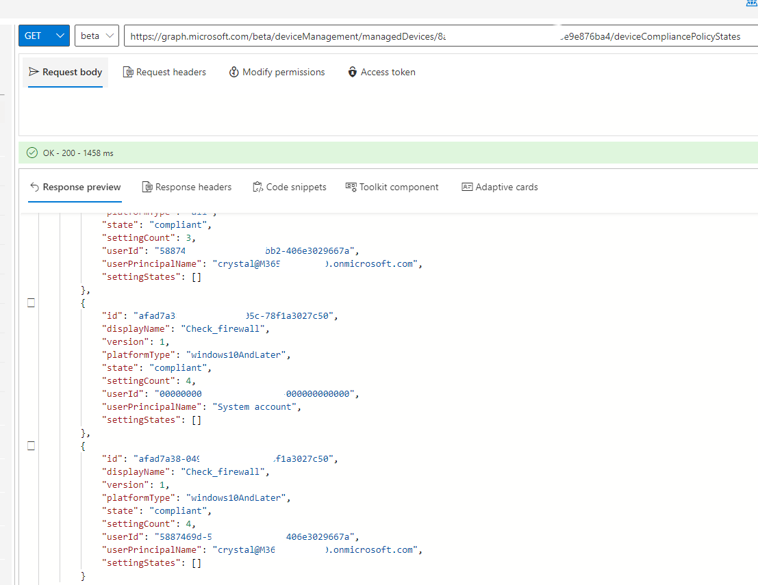

    @Sara Caballero, Thanks for posting in Q&A. Based on my testing, we can use the following API to get the compliance policy and its state on one managed device.
    Action: Get
    URL: https://graph.microsoft.com/beta/deviceManagement/managedDevices/<managed device id>/deviceCompliancePolicyStates
    Meanwhile, I find one link list some scripts to get Intune compliance data. You can read it to see if it can help.
    https://doitpsway.com/get-intune-compliance-data-using-powershell-leveraging-graph-api
    Note: Non-Microsoft link, just for the reference.

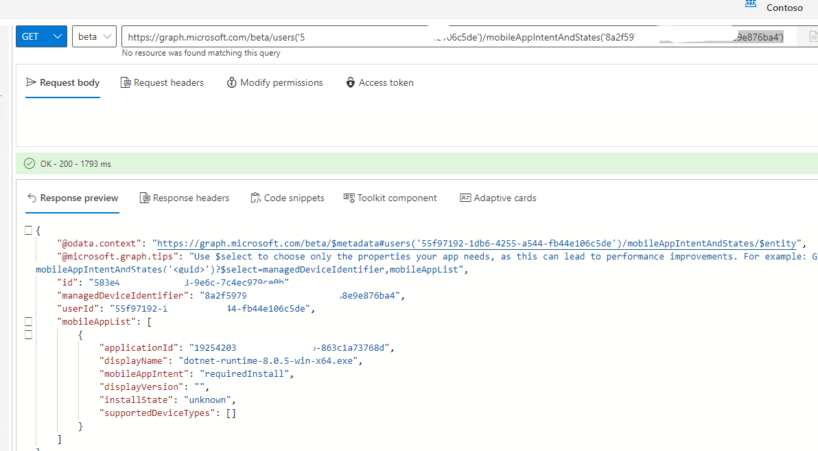

    To get managed apps on one device, we can query via the following method.
    Action: Get
    URL: https://graph.microsoft.com/beta/users/<user-id>/mobileAppIntentAndStates/<device-id>
    In addition, i find a link describe to do this via PowerShell script. You can also refer to it.
    https://andrewstaylor.com/2022/07/26/detecting-which-machines-have-which-intune-applications-installed-via-powershell-and-ms-graph/
