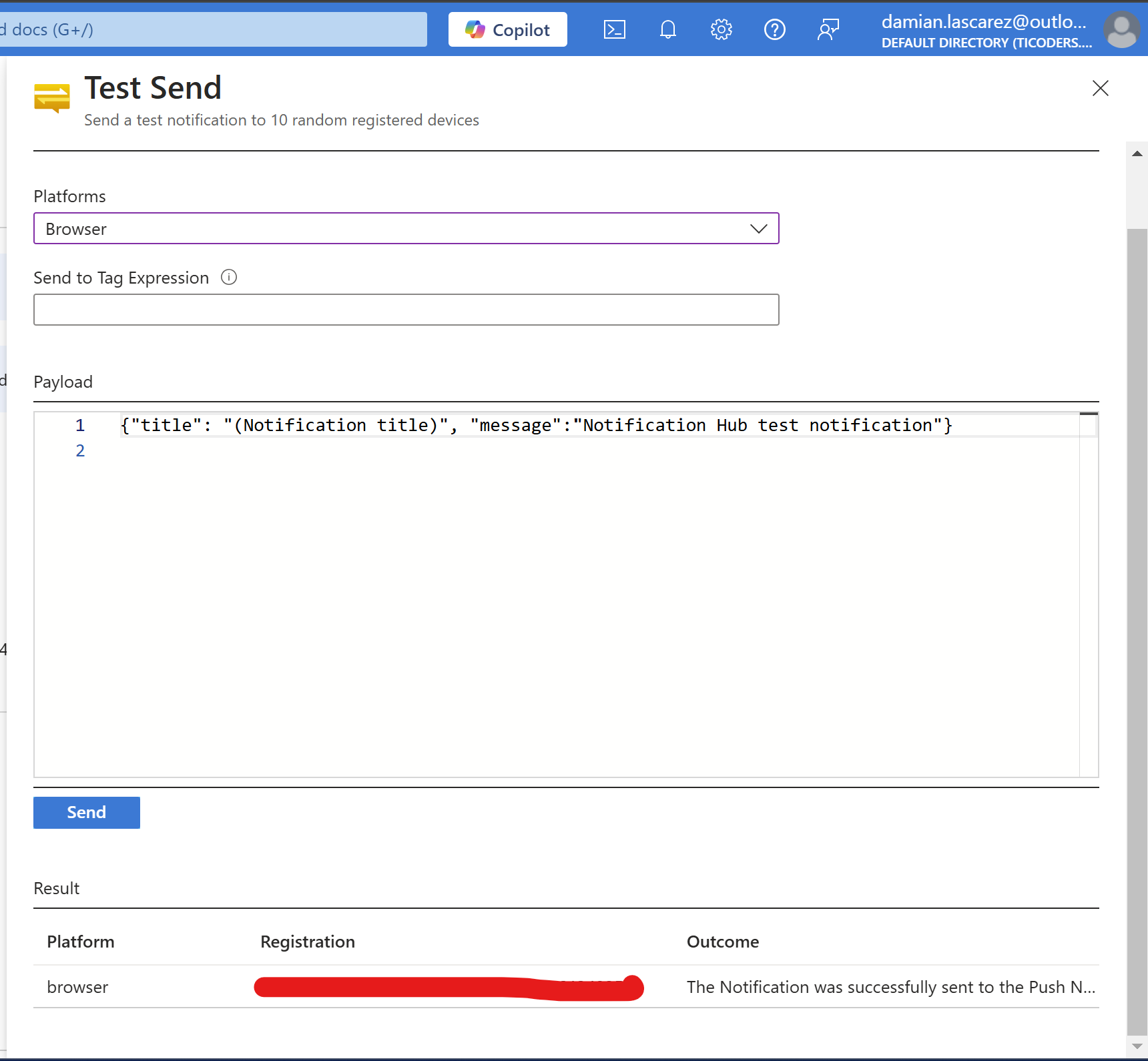

    Once you have your browser registered, you can use Azure Portal to test the Push:
