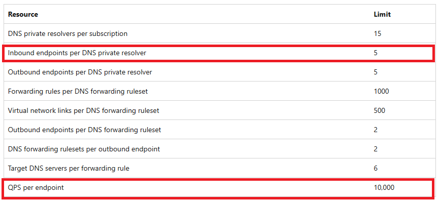

    Azure DNS Private Resolver is a multitenant service but has some restrictions and limits that you need to consider. Below are some of the important restrictions that you should consider:
    • DNS Private Resolver rule sets can only be linked to virtual networks that are within the same geographical region as the resolver.
    • A virtual network can't contain more than one DNS private resolver.
    • When you link a ruleset to a virtual network, resources within that virtual network use the DNS forwarding rules enabled in the ruleset. A ruleset can be linked to up to 500 virtual networks in the same region.
    • You can also link a ruleset to a virtual network in another Azure subscription. However, the resource group specified must be in the same region as the private resolver.
    • A single ruleset can be associated with up to 2 outbound endpoints belonging to the same DNS Private Resolver instance. It can't be associated with 2 outbound endpoints in two different DNS Private Resolver instances.

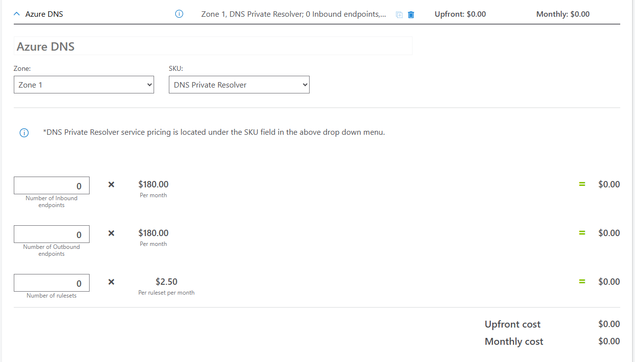

    For Azure DNS Private Resolver pricing, you can refer: https://azure.microsoft.com/en-in/pricing/details/dns/
    And also use the Pricing calculator to get the actual cost:
    https://azure.microsoft.com/en-us/pricing/calculator/
    So, if all your Azure Vnets are in a single region, you can use a single Azure DNS Private Resolver with a single inbound and outbound endpoint to link all your Vnets to it for dns resolution. The number of rulesets could vary depending upon your requirement.
    But if you have Vnets in multiple regions, then a single Azure DNS Private Resolver will not work. You will need an Azure DNS Private Resolver for each region.
