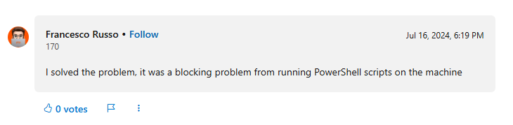

  2. Crystal-MSFT 53,991 Reputation points Microsoft External Staff
    2024-08-08T02:32:02.5466667+00:00
    @Francesco Russo, I notice your issue is resolved. To help others quickly find the solution. Please let me write a brief summary:Issue:
    I have a custom compliance policy with a PowerShell script on almost all PCs it has been applied and they are compliant, but 4 PCs says it is not applicable
    Resolution:
    Thanks for your time and have a nice day!
