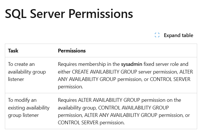

  2. Oury Ba-MSFT 20,926 Reputation points Microsoft Employee Moderator
    2024-07-17T19:30:06.62+00:00
    @Stu Thank you for reaching out.
    Seems like you are getting an access denied error message when trying to update an existing high availability group listener in SQL server.
    As an owner of the subscription, you should have the necessary permissions to modify an existing availability group listener.
    To create the first availability group listener of an availability group, we strongly recommend that you use SQL Server Management Studio, Transact-SQL, or SQL Server PowerShell. Avoid creating a listener directly in the WSFC cluster except when necessary, for example, to create an additional listener.
    https://learn.microsoft.com/en-us/sql/database-engine/availability-groups/windows/create-or-configure-an-availability-group-listener-sql-server?view=sql-server-ver16User's image
