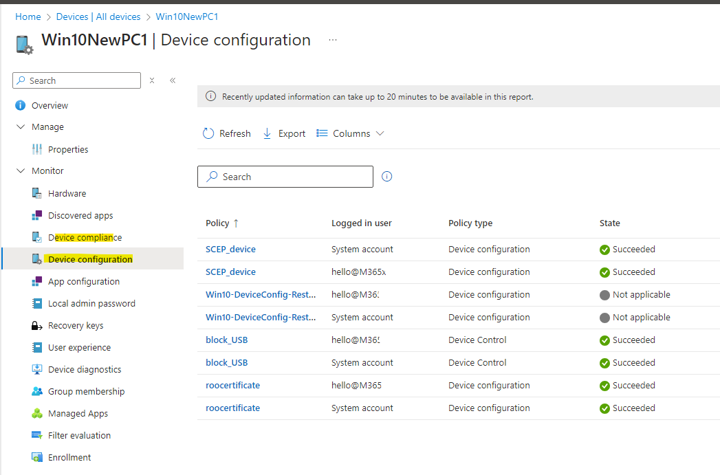

Hi all,
is there any way to display all the policies applied to a PC joined to EntraID with active intune?
What I am looking for is kind of what used to be done with the gpresult /h command when the pc is joined to a local AD
Thanks

  2. Crystal-MSFT 53,986 Reputation points Microsoft External Staff
    2024-07-15T01:25:02.0533333+00:00
    @Federico Ciampi - ReeVo, Thanks for posting in Q&A. To check the policies applied to one PC, just as glebgreenspan said, you can go to Devices>All devices>Find the PC you want to check. Check all the configuration policies on the device, we can click "Device Configuration", check all the compliance policies on the device, we can click "Device Compliance"
    Hope the above information can help
