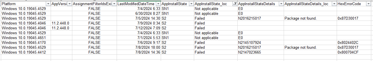

The first it looks like there is a difference between results by apps and by devices. For example, I have 2 computers - when I check the installation using Intune - Apps - Company portal, it shows failed, when I go to devices - select device - managed apps, it shows installed.
test1 The second issue is with the error codes. I have some error codes which are missing in the https://learn.microsoft.com/en-us/troubleshoot/mem/intune/app-management/app-install-error-codes
For example:
test2
Another example is:
By Apps I've exported the report and it shows Error 0x800704CF.
As well you can see that last check-in was days ago but Intune portal by Apps is not updated. And I'm using Google chrome in incognito, but with Edge it was the same.

    @Borislav Vitanov, Thanks for posting in Q&A. From your description, I know there are two computers have issue when deploying company portal. From the screen shots, it seems the application is installed successfully on 6/24/2024. Lately, it seems there's update for the application, but it is failed to install the update version. As the original is installed, we may see the app shows installed under managed app.
    For the error code, based on my researching, iI don't find the detailed description. Maybe it is a general error.
