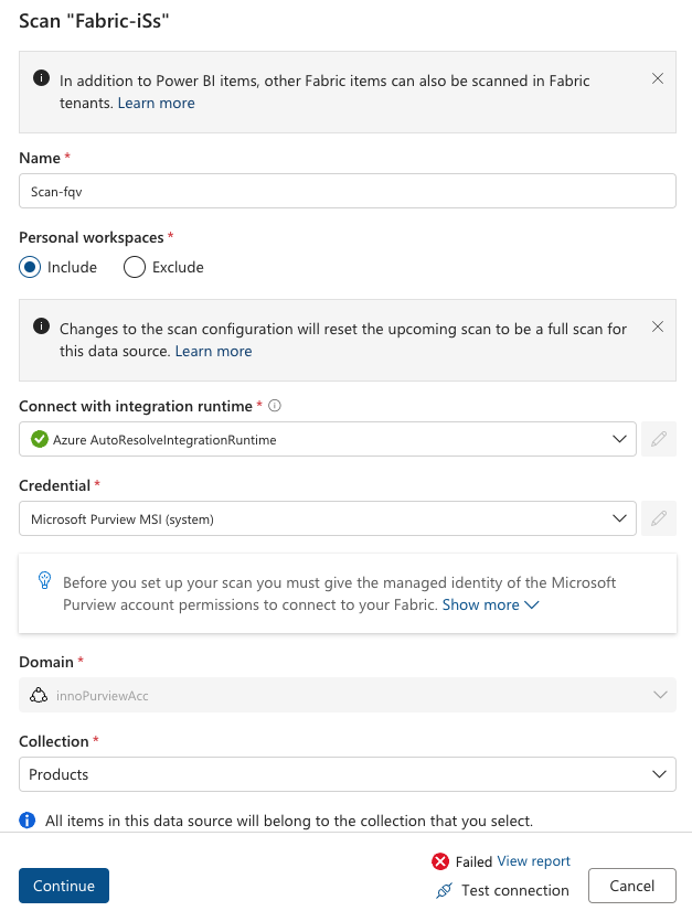

I am trying to use my tables in OneLake as a source of data for Purview.

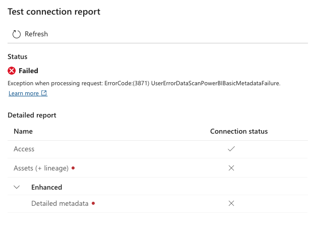

I setup the fabric connection as follows and then test the connection which fails
When looking at the details I get the following error: Exception when processing request: ErrorCode:(3871) UserErrorDataScanPowerBIBasicMetadataFailure.

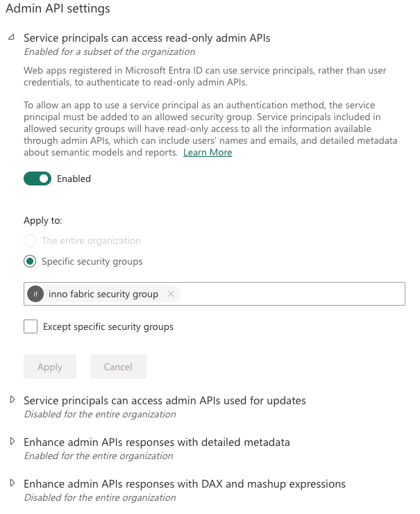

The API configuration in Power Admin should be correct:User's image

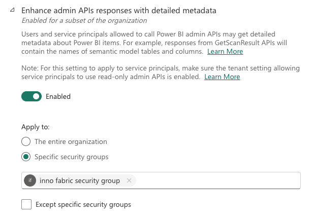

    The issue was I had not enabled the setting for enhancing dax and mashup expressions in api response, this needs to be enabled.
    This documented here Connect to and manage a Power BI tenant same tenant | Microsoft Learn but I missed it as it was merged with another setting. :-(

    Regarding the error you're experiencing, ErrorCode:(3871) UserErrorDataScanPowerBIBasicMetadataFailure, it's likely due to an issue with the metadata scanning of your Power BI items in the Fabric tenant. This error suggests that there's a problem with the basic metadata of your Power BI items, which is preventing the scanning process from completing successfully.
    To troubleshoot this issue, I recommend reviewing the setup steps again to ensure that everything is correct. Specifically, double-check the following:
    • Your Fabric and Microsoft Purview accounts are in the same tenant.
    • The Fabric tenant ID is entered correctly during registration.
    • The Fabric Metadata model is up to date by enabling metadata scanning.
    • The Microsoft Purview Account Network is set to public access in the Azure portal.
    • The Fabric tenant is configured to allow public network in the Fabric tenant Admin Portal.
    • A security group is created in Microsoft Entra tenant, and the Microsoft Purview account MSI or service principal is a member of the new security group.
    • The "Allow service principals to use read-only admin APIs" option is enabled for the new security group in the Fabric Tenant Admin portal.
